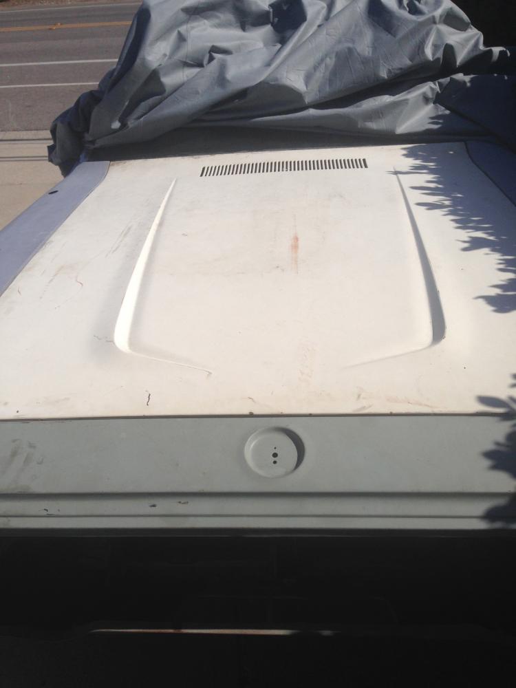

I have a 1972 Roadrunner with a 440 4bbl. I need to cut the hood to install an air grabber in or on it? Has any one attempted or completed this? Or maybe has a template or measurements that could be helpful? Any info would be greatly appreciated, measure twice cut once!!
My '72 RR has the factory air grabber hood on it but it in no way resembles the other RR hood with the call outs on it. Please post a photo of the hood you are intending to cut and maybe then we will be able to assist you.

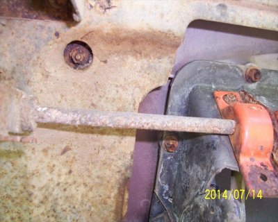

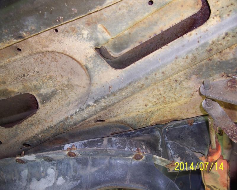

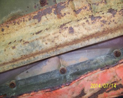

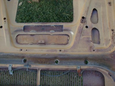

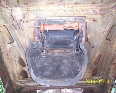

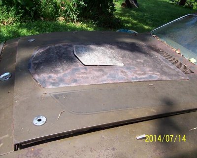

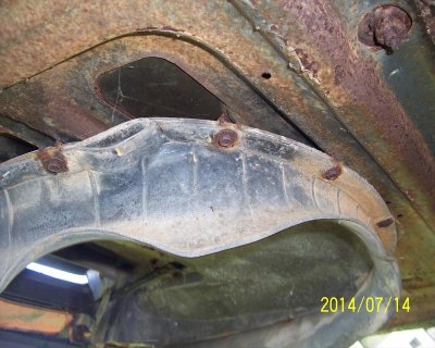

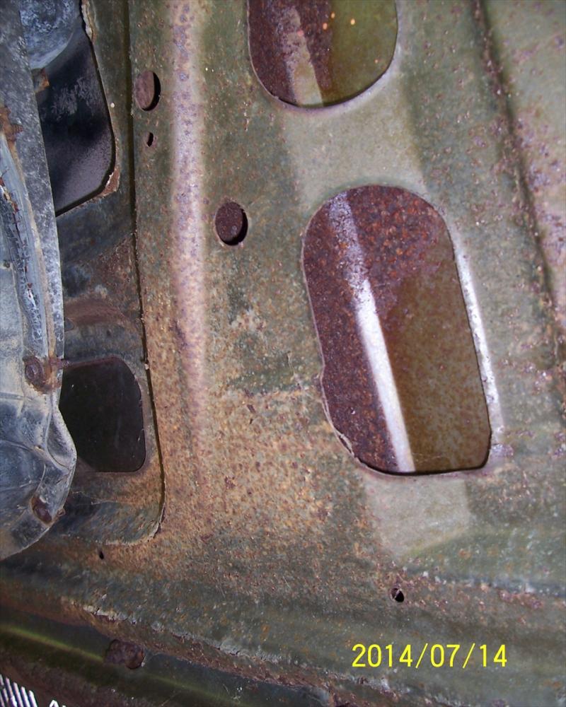

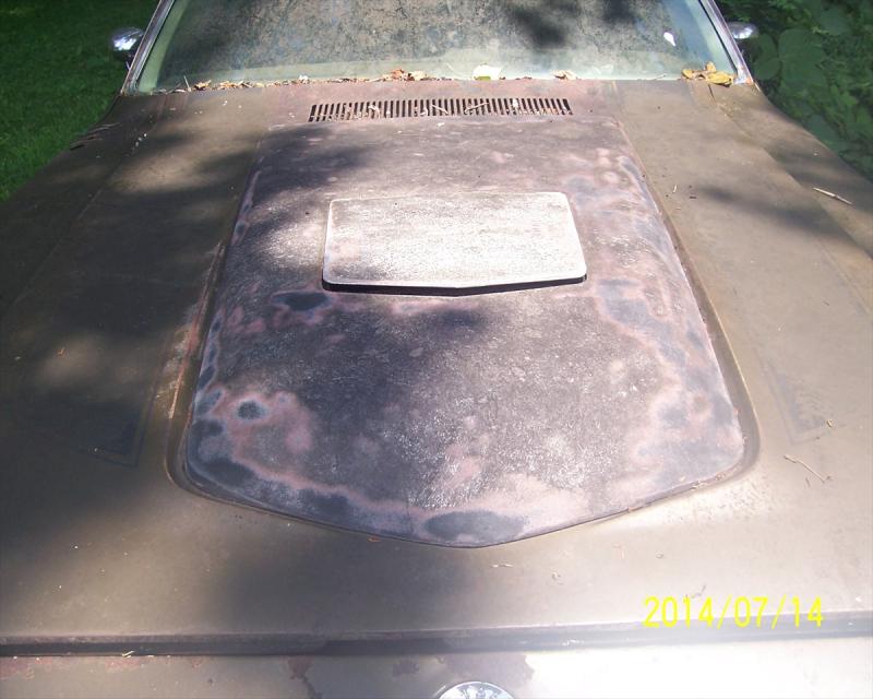

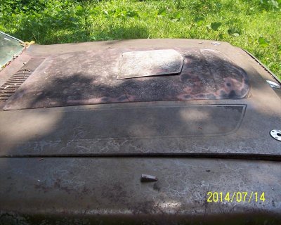

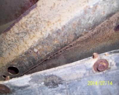

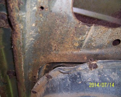

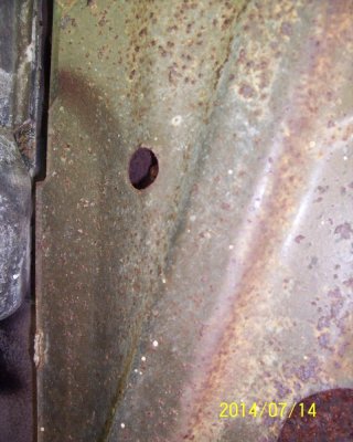

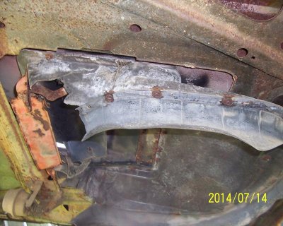

Here are some photos of my hood. Sorry for the poor quality but I've been mostly blind since Thanksgiving last year and a few outer health issues has prevented them from operating on me. Suppose to happen on Wednesday I hope.
72roadrunnerGTX has put the drilling points (i can't read them) and maybe these photos will help. Notice the hole itself is not nearly as large as the fiberglass insert is. Also notice the larger holes on the inner structure that allow access to the nuts that hold it on. If you may need clearer pictures I can get my son to come over and take a few.
Bill100_7895-1.jpg100_7906-1.jpg100_7897-1.jpg100_7898-1.jpg100_7899-1.jpg100_7900-1.jpg100_7901-1.jpg100_7902-1.jpg100_7903-1.jpg100_7904-1.jpg100_7905-1.jpg100_7896-1.jpg100_7907-1.jpg
My air box is broken but when I can get back to working again I will order a new one.
Thank you for the excellent information!!! The drawing and photos are very helpful!! If any one has a couple of complete and restored photos from the under side and top would be greatly appreciated! I will be on vacation soon but when I return I will post pics of my air grabber repair, and installation.

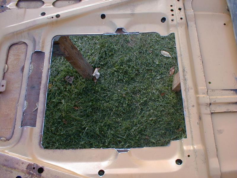

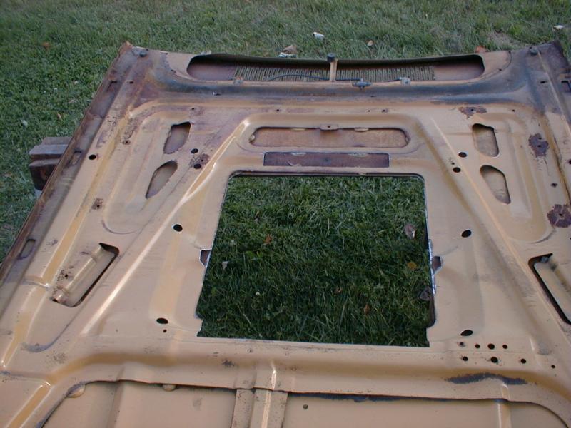

I used the diagram above as posted by 72RoadrunnerGTX to complete my air grabber hood project. The diagram was given to me by Mike over at BE&A, who has had a ton of expeirence with these setups. i followed the instructions, measured twice - cut once type of deal and everything came out ok

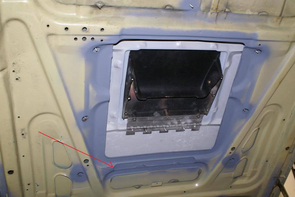

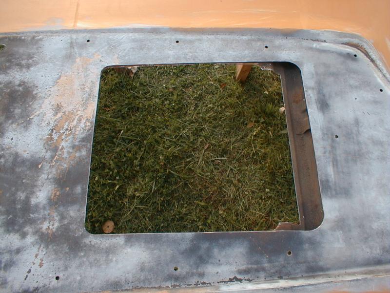

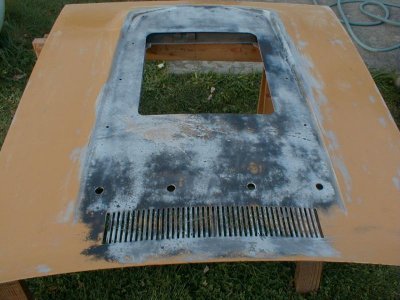

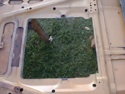

FYI the inner and outer skin cutouts do not match. Here's one I did a few years ago.
