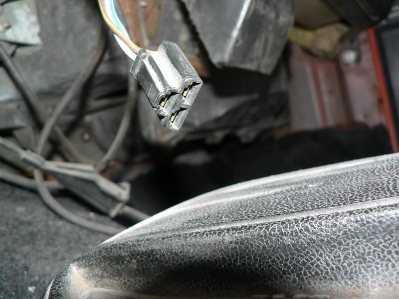

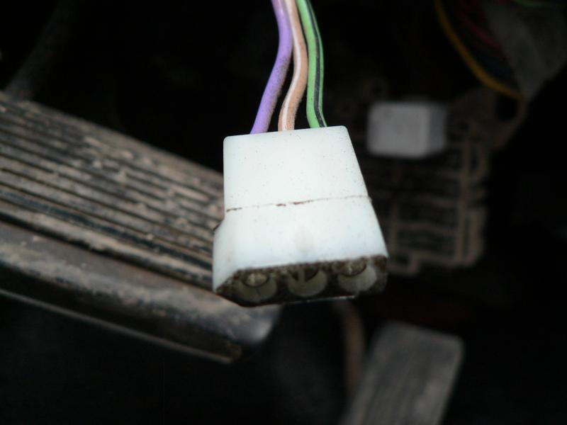

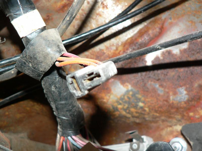

Soo happy my electrical is coming together just a few ques....
Ive got 3 unidentified connections unsure of where they go ...
If you recognise them... shout out the answer...​

#1. You have a replacement turn signal switch with an additional turn lamp switch lead. You can disregard it as it not used in the b-body.
#2. Is the radio power connector.
#3. Is the connector for the seat belt warning system relay. Should find it mounted to the lower dash frame between the ash tray and glove box if it is still present.
Fuse panel clips over the firewall bulkhead connector, one of the clips can be seen in your second picture.
