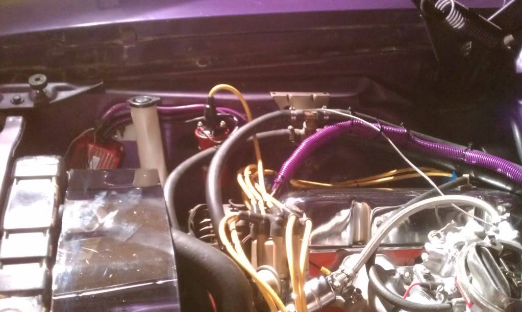

Need pics of a 72 Satellite/rr/gtx/charger washer bottle location
Totally missing my washer bottle/pump/hose to hood when I bought her-

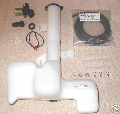

Is this a good price for a replacement peice or should I go to a diff suplier -
fleabay-158+sh
http://www.ebay.ca/itm/1972-B-Body-Charger-RoadRunner-Satellite-W-S-Washer-Set-/370322162469?_trksid=p5197.m7&_trkparms=algo%3DLVI%26itu%3DUCI%26otn%3D5%26po%3DLVI%26ps%3D63%26clkid%3D5882878901262230770
year one-3 items added up 141.00+ and they like to overcharge shipping

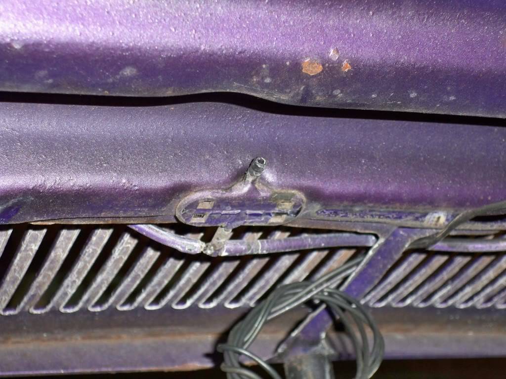

Ok, here we have where the sprayers are mounted to the hood. In between, you can see the nozzle for the hose.

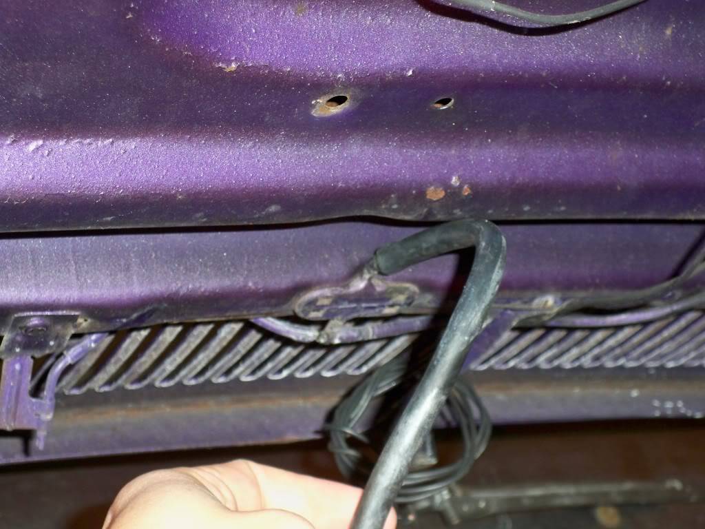

The hose on the nozzle;

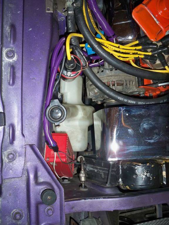

This is where my bottle is mounted, passenger front fender.

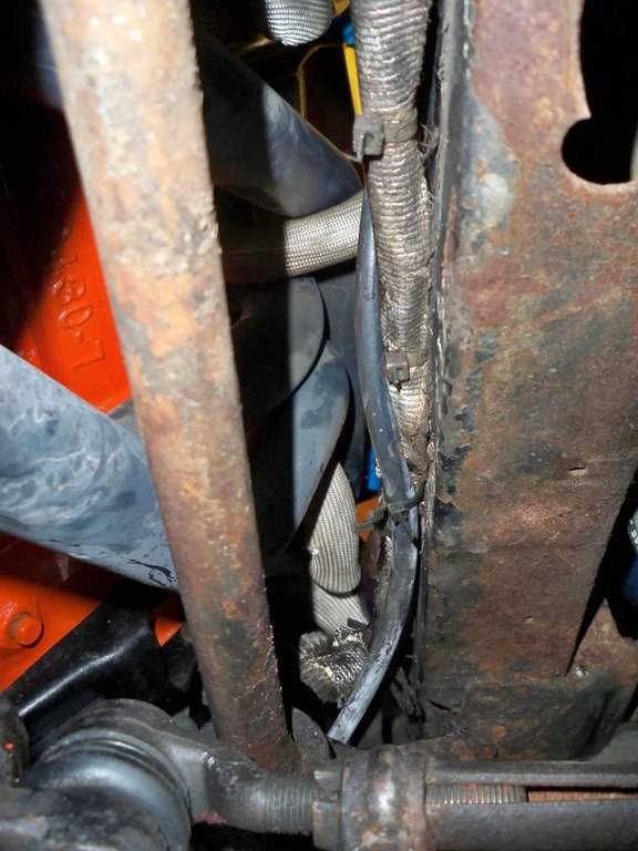

Here's where it comes down from the nozzle, traveling under the engine bay behind the passenger front fender well.
Here's a peek at it through the wheel well. It's actually nowhere near the headers, that is trick photography, I swear! lol
Here it is running along the frame
Here's where it venture up toward the bottom of the bottle a decent bit away from the block.
This is how it attaches to the bottle. Disregard the purple wire looms, that is what's housing the wires from the harness that activate the squirters. Gotta keep that messy car as tidy as possible.

If you go that route get the bottle only. The pump hoses and fittings can all be had at your local auto parts store at least as good quality aBetter price and no shipping cost.
I found one of those bottles for about $50. the rest of that stuff ain't worth a hundred dollars.
