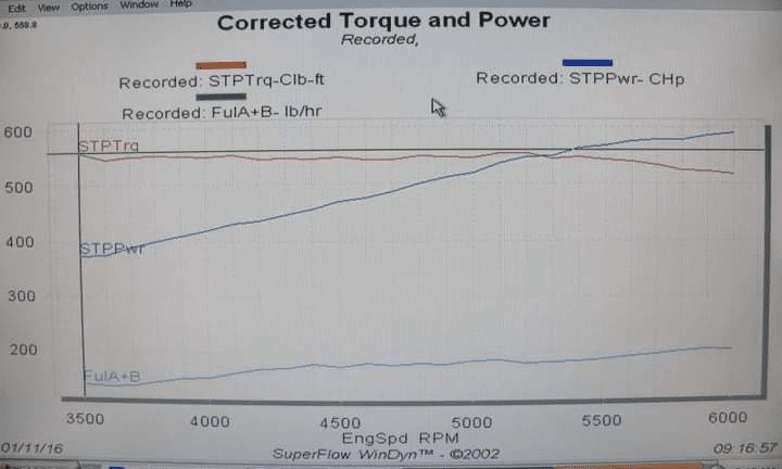

Jeff if mine will do that, it'd be perfect. My peak HP is 58-5900.
Dyno
