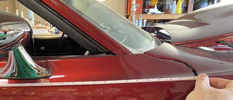

It should get the same backing plate than the driver side. The plate is not just to get a fastener, but also reinforce the door skin. The riv-nuts were used on earliers
I installed my passenger on same spot than driver side, and I'm pretty sure that's the right spot, since we don't have vent window post in the middle

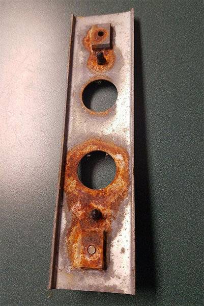

I don't have measurements for you, since my car doesn't have a passenger mirror, but I have a photo of the backing plate. You see them on ebay once in a while.
here is a photo from my 1973 SE
Thanks to all for the information. It looks like the passenger side mirror also uses the backing plate inside the door. It looks easy enough to make one using the measurements off my drivers side mirror. And thanks to Corman, I now have the measurement to place the mirror.

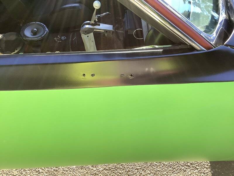

Maybe these pictures will help. There are 2 fasteners that hold the plate to the inside of the door. The screws were machine threads as I recall. The pictures were taken while I was wrapping the car.

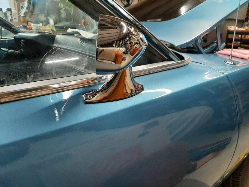

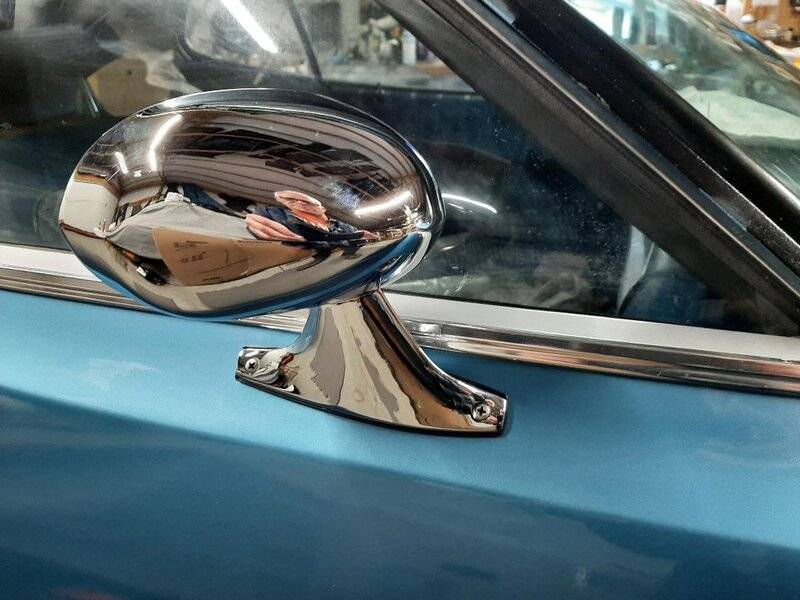

I very much appreciate everyone's input. The mirror is on. What I did was take a piece of steel faltbar that was 1 inch wide and 1/8" thick and cut it to the length of the mirror base. I drilled the two holes that would mount the mirror base to the plate and tapped for 10-24 screws. I then marked the door skin for the mirror base and drilled the holes through the door skin. With the window down and no inside door panel, I was able to mount the plate to the inside of the door with the screws and washers ( didn't mount mirror yet). I then measured for the plate holding clips and drilled those two holes through the door skin and plate. I then mounted the plate using two plastic push pins and then installed the mirror using the machine screws. See the end result below.
