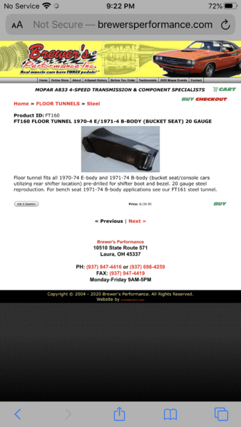

Hello everyone. Just curious if any 73/74’s
RR/ Satty’s used the rear shifter mounting location on the tail shaft for a 4spd? Not sure if 71/72’s are the same. I have a 74 Satty that I’m in the beginning stages of converting to a 4spd, bucket seat,
NO council. Ordered the tunnel from Brewers, he recommended getting the rear location hump. I know I’ve seen pics of forward mount with buckets no council and the shifter bends back towards the driver. Just wondering if anyone has knowledge or even pics of rear mounted shifter, bucket seat, no council. Thanks for any reply’s

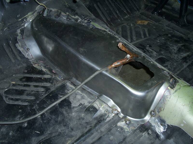

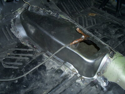

Here is my 72 conversion with rear mounter shifter, no console. I agree with Outlaw on the benefit of the short shifter.

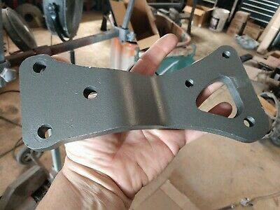

This is the shifter and bracket that I have seen on the non console 71-74 cars that I have owned and worked on. It pushed the shifter back between the pads on the tranny and above the crossmember.

If that pushes the shifter back from the front mounting location, how does it utilize the rear mounting location? Does that plate bolt to both locations and the shifter then mount to the plate? I apologize for my lack of knowledge.
Plate in post 8 is for the front mount location and long shifter.
