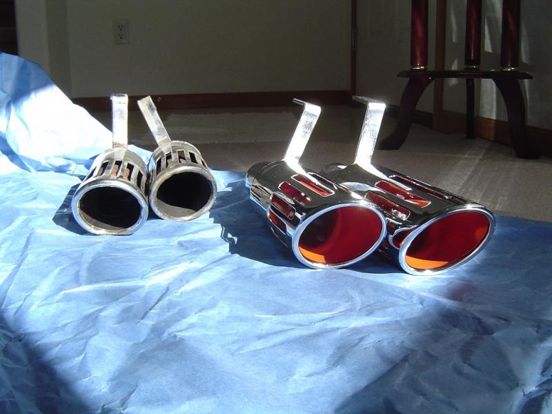

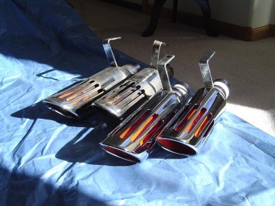

Here are my new Machine gun tips, next to the original ones! lol, love it. Looks like chrome exhaust tips were on all 73 roadrunner with a 318, 340, 400 and 440 with dual exhaust.
No indentations ever on 73-74s have owned them both since 76, all have had tips, but the were an option, currently own 3 all 400 4 speeds. all with tips and no identations on rear valances. Also own 73 Rally Charger the DO have indentations for tips, also 400 4 speed. If you use factory hangers for tips on RR's, they will be about half to three quaters of an inch below the valance.

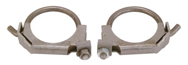

idrivemopar how are they holding the tips to the pipes are they using u bolts? Thanks
The tips are held in the exhaust pipe, which originally was flared and slotted on 4 sides if you will so the tip would go into this flared end, and then was clamped with a special type of clamp, shown below.
Additionally, the tips as i showed in the above picture, have a right angle hanger that goes into a rubber mount that bolts to the body.
