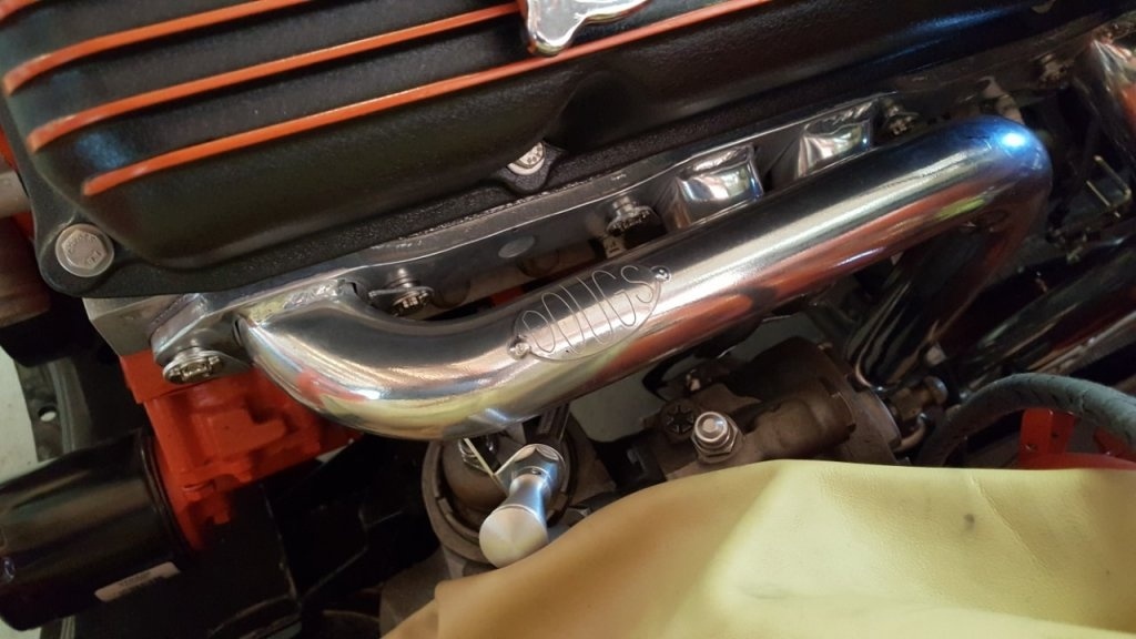

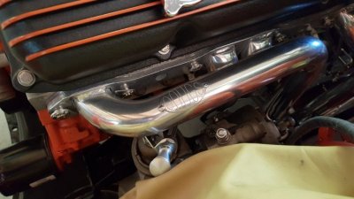

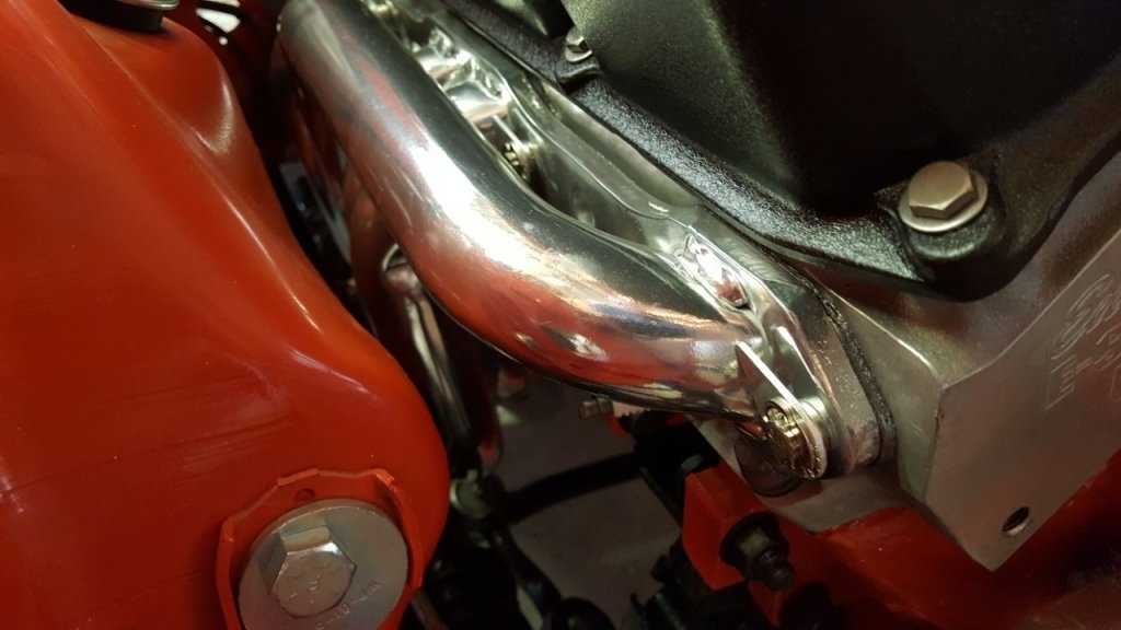

Just installed Doug's on mine. The tranny linkage don't come near them at all

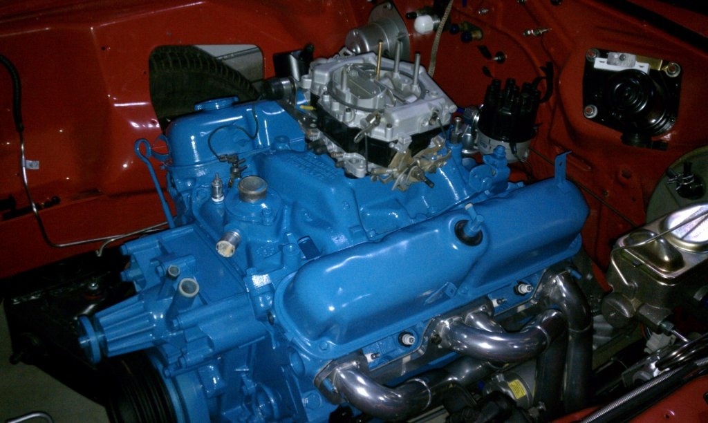

Heddman 1 5/8” headers on my small block 73 Charger Part# 78050
