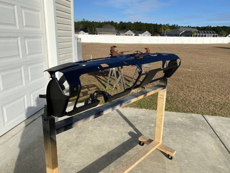

Make a handy stand to mount it to while you work on it.

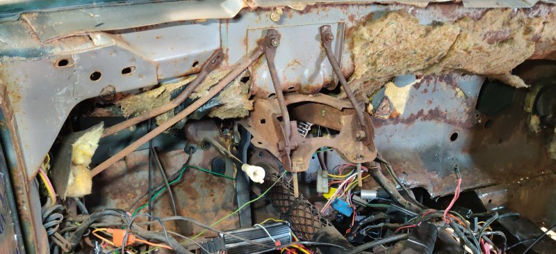

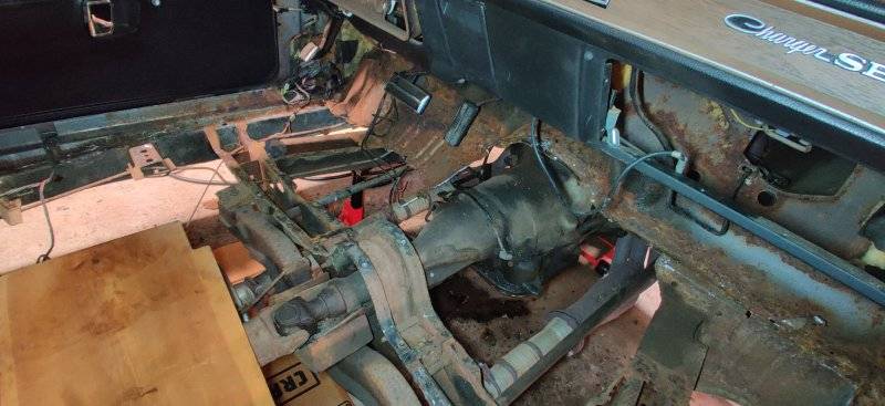

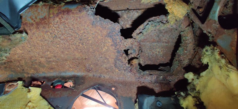

Gotta get it out of the way for the floor pan. There's also a hole in the cowl where the air inlet was that I need to patch.

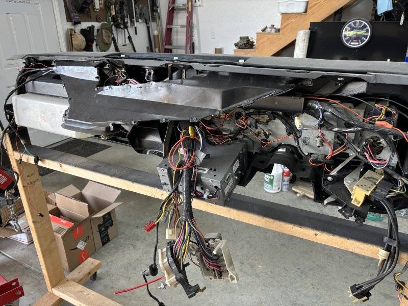

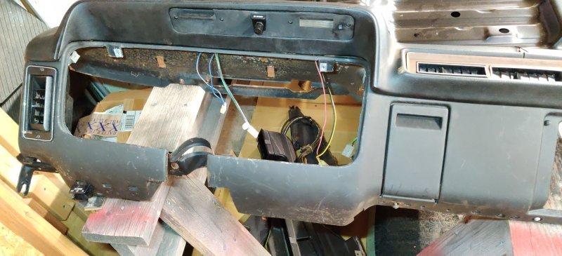

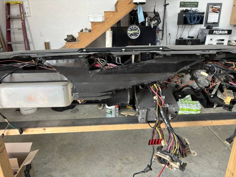

Update

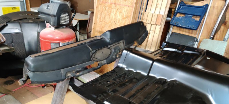

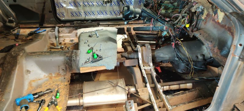

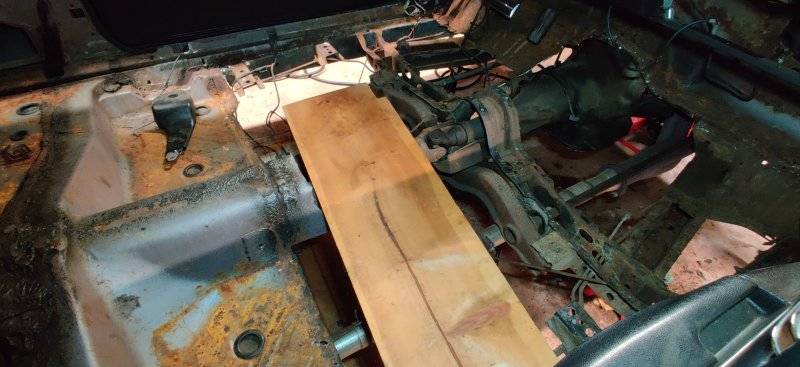

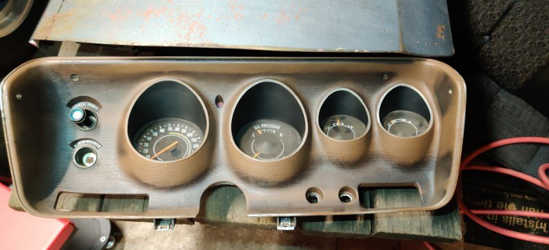

The dash is out... finally... Whoever the engineer was who decided it was a good idea to put those 1/4 inch hex screws right up against the windshield on that stupid angle is guaranteed a special placed in hell, I swear...
I also didn't realize how much of a PITA it was going to be to deal with the wiring harnesses. Apparently you do have to disconnect everything and then pul the cluster before the dash will come out.
Managed to break the wire going to the passenger door sensor right at the sensor so that's going to be fun to fix :rolleyes:
Lots of cleanup to do. Then the "fun" part of getting the new pan in and priming.

It was designed that the entire dash be removed and installed fully intact. Disconnect the engine side harnesses at the bulkhead connector, pull the two nuts securing the bulkhead to firewall, disconnect the rear body harness at the kick panel, door pin switches, disconnect the any heater control cables. Never had an issue accessing the upper speaker grill with the windshield in place with the correct tools. Beats the previous design of this platform requiring the windshield to be removed to pull the dash.
BTW, removing the steering column is just a few more minutes up front, saves a lot of struggles later working around it. This service procedure is well described in the FSM, step by step.

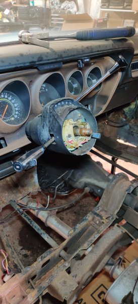

Is the steering column really just the two bolts at the universal joint or is there more to it than that? It really does need to come out, get some cleaning, and paint.
Knock the roll pin out at the gear box input shaft, pull the column out, looks like you have everything else loose. Just noticed the column shifter, will need to disconnect the shift linkage as well.

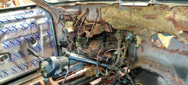

Hello, I was reading your thread and noticed in one of your photos the insulation/sound deadener on the front door inner. What is it and have you used it before? Thanks!
It's called "FatMat" I got it on Amazon. Comes in different lengths Amazon product ASIN B00HZWSN3WI'm planning to use it on the floor as well as the doors. I got 75 sq ft of the stuff and still have probably more than half left after just doing the doors. Not sure if I'll need more than what I have to do the floor or not.
Works really great in my opinion. I could tell a difference just by doing the doors, and I still had literal holes in the floor!
Thanks! I did the floor pan with something just like DynaMat.

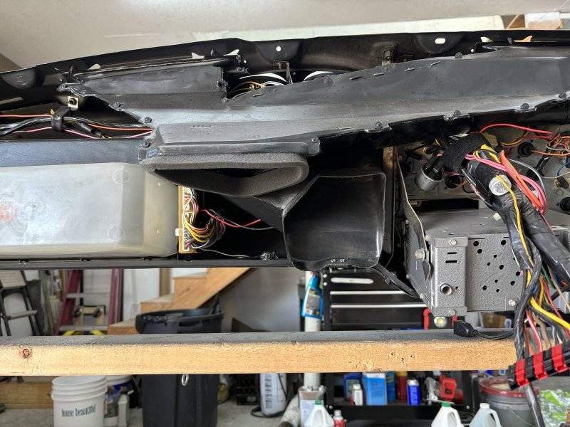

Does anyone have a good picture of the vent system for a 1973 Dodge Charger with AC. I'm converting to AC and I can use any help. I do have the vents for dash. I need the one for the defrost. Sent pictures. You can also text me 254-247-9821
