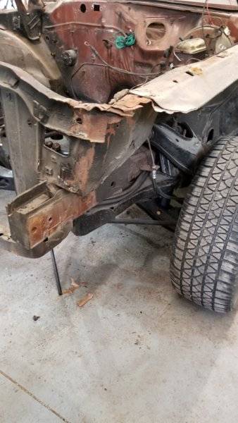

I am looking for front inner fender for my charger and I am having a very hard time finding some for the 73 charger I find a lot for up to 72 but not beyond so my question is this does anyone have a idea as to where I can find some or do you know if the 72s will fit just fine the only difference I can tell from the pics are the shock towers but how much can you really tell from a sales pic thank you for any info and knowledge you can send my way

Inner fenders, No, need the correct ones. Passenger side changes too since 73 between BB and SB car.
Edited the previous post a bit.
Frame rail is at diff height too an makes a big diff too. UCA is not anymore attached to unybody since 73 like they are on earliers, battery area is way diff etc... you can fit anything you want with a hammer and welding machine thought LOL
Fenders itself can interchange, but they got their differences on some interior areas which don't make a perfect bolt on assembly, aside the wheel opening height and 71 sidemarkers.

Agree totally different between 71/72 and 73/74.
However should be same as 73/74 Plymouth.
Big block pass side has cut for spark plug access but SB can be cut to match.

yea I would be interested let me know how much and maybe a couple pics so I can asses repair needs but definitely interested cause this is what I have currently
