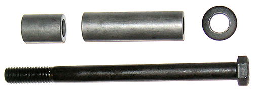

I am hoping someone here could please provide a photo of the top Alternator Bolt with the bushings (mounted in the car) for a 73 400 with AC. Here is a pic of the bolt and bushings I am referring to: 400withACBoltKit2.png
The long spacer goes between the ears of the alternator (it keeps the bolt from squeezing the ears together and possibly breaking one off, the short spacer goes between the alternator and engine block, and the washer goes under the head of the bolt.
Thanks!
