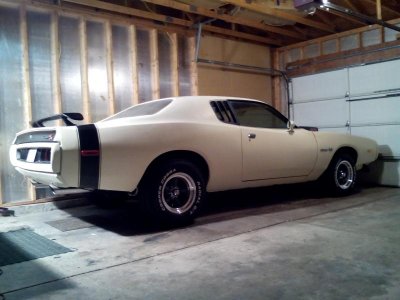

i like to fill my wheel wells, so I use a 255/70/15 or 275 / 60 /15 on the rear and a 225/ 70/15 on the front all with 7 , 8 and 8 1/2 sometimes 10 inch wheels.
here is a 255/70/15 on an 8 1/2 inch wide wheel. I do not use the 50 series tires because they have short side walls

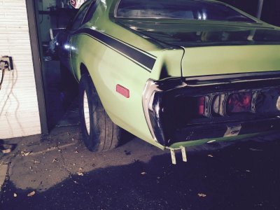

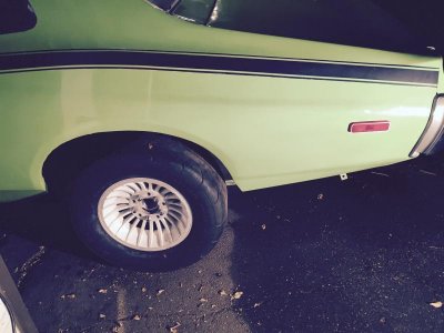

Well decided to get some 275/60/15 Mickey Thompson ET street radials.
From what I see it seems to fill the gap amazing will get some pics once they are mounted
Sweet, I always wanted Mickey's for my 73. I just couldn't throw that kind of money at it for the car being a daily! Can't wait to see it.

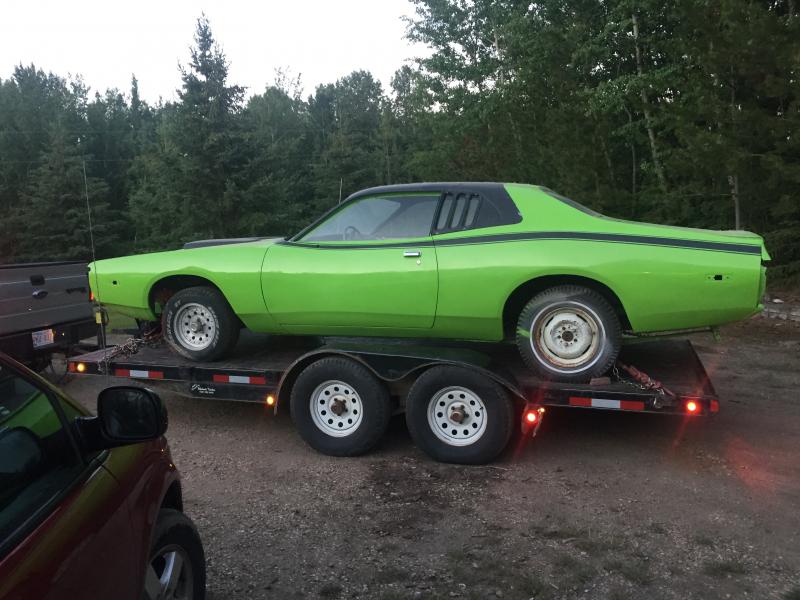

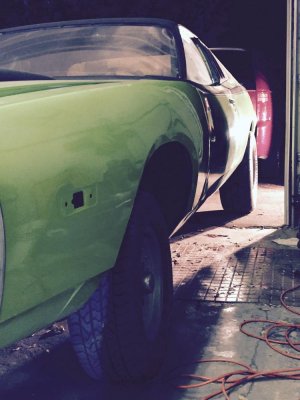

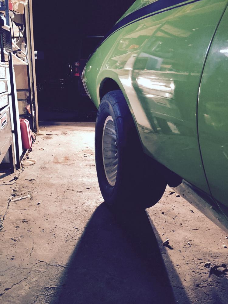

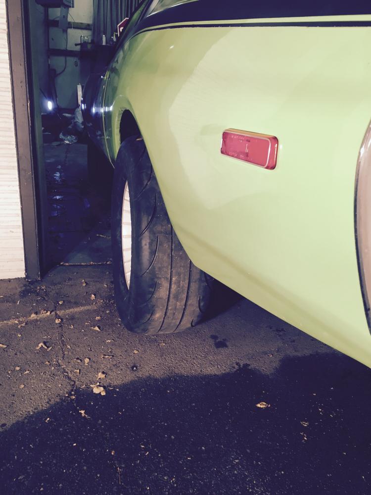

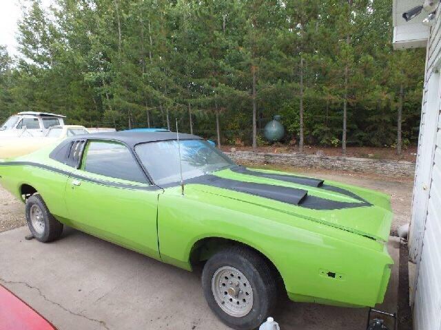

Little late but better than never, just a quick test fit with no center caps or anything, no motor or interior.need a little more weight to drop her down in place, but here is a test fit for my charger and Mickey thompsons 275/60/15
