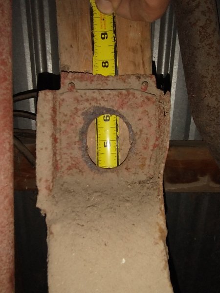

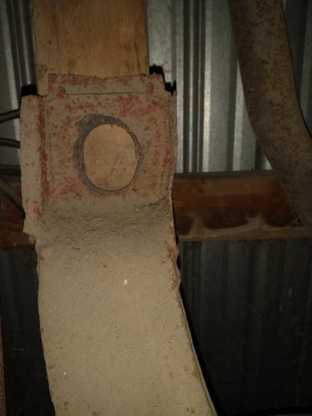

Since I can't seem to locate a K frame close enough to me I'm thinking I will have to repair my current one. It's mostly in good shape but the back body mounts are rusted out around the rubber isolator. Does someone have one they can shoot some photos of how these areas are supposed to look? Would like some measurements too if possible. Looking for the hole shape and size. I have a fabrication shop which should be able to make and weld in some repair peices for it.
If anyone knows where the big block mounts are relative to the small block mounts, that would be helpful too. Im swapping in a 440 and would consider moving the mounting tab to the proper location while they are at it.
I have a k frame out that should be able to get some pictures of the rear holes
