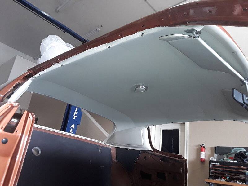

Just to clarify what I thought you were asking for. I could could not find repro replacement plastic sail panels that cover the rear pillar. I found some on Ebay but decided to try and repair and recondition mine. They turned out pretty good, still a little warped but they will do for now.

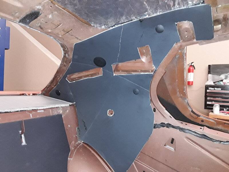

Also could not find anyone that made repro insulation so I had to make my own replacement insulation panels. I made the template of the originals then cut the pattern on EVA insulation then glued it to a piece of matching thin fiber board. Then installed using retainer clips just as the factory did.
