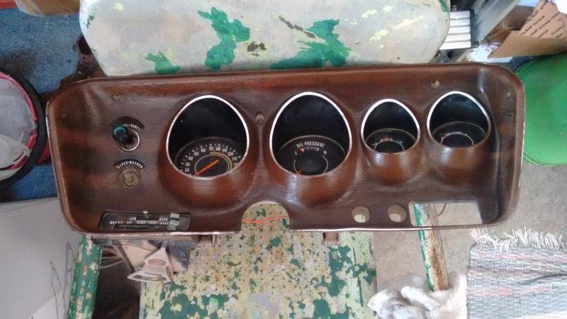

The bezel will come out with the cluster. Once on bench you can remove the bezel. Can’t remove just the bezel with cluster still on car.
Meaning with this, once you removed Radio and unplugged everything, drop the column, remove screws (there are two hidded down the column “tunnel”) then proceed. No need to remove switches or knobs on this stage.

The cluster will come out like this… thenyou’ll be able to remove the bezel, since is attached to housing with screws from behind (aside remove also the switches nuts of course)
