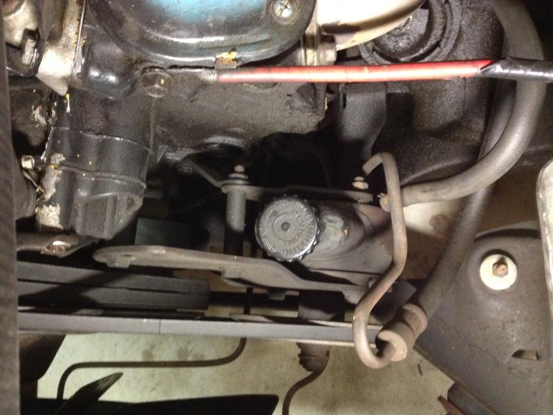

If you need pictures of a 73 Road Runner with power steering let me know and I can get you some pictures.

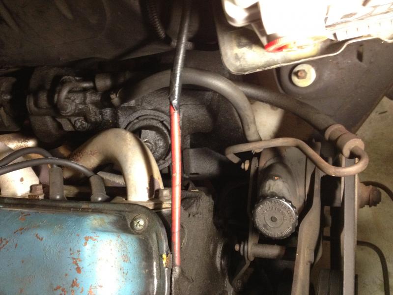

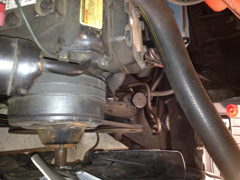

Power Steering Pics
Sorry for the delay, I've been tied up with work.
Note this is an A/C car, so if you do not have A/C your belts may run differently.
Sorry, it is a bit grungy and dirty, but it is a daily driver! Hope these help!
