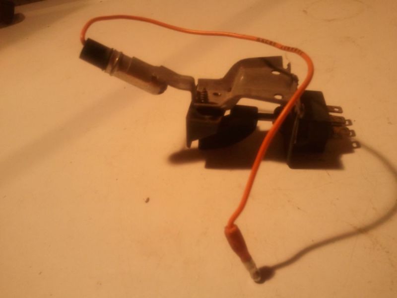

Is this some kinda light above the gauge cluster and if so, what should one really look like?
This is fun, putting things back as they should be on a classic car isn't it. I wish I had more experience
with these 73 RR' s. It would go a lot quicker (maybe). But if so what fun I would miss.
vbpgimage.php
That went to the fasten seat belts light.
A map light there was an option but takes a different set of wires.
That's a map light option.
Not to hard to find on ebay and fairly cheap.

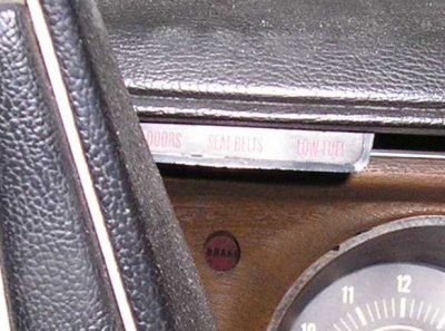

Two lights are there... maplight you can switch on manually or with opening the doors..... and the second light at the other end is "Fasten seatbelts"

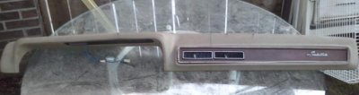

I'll check my spare Satellite dash when I get home tonight and report back here.

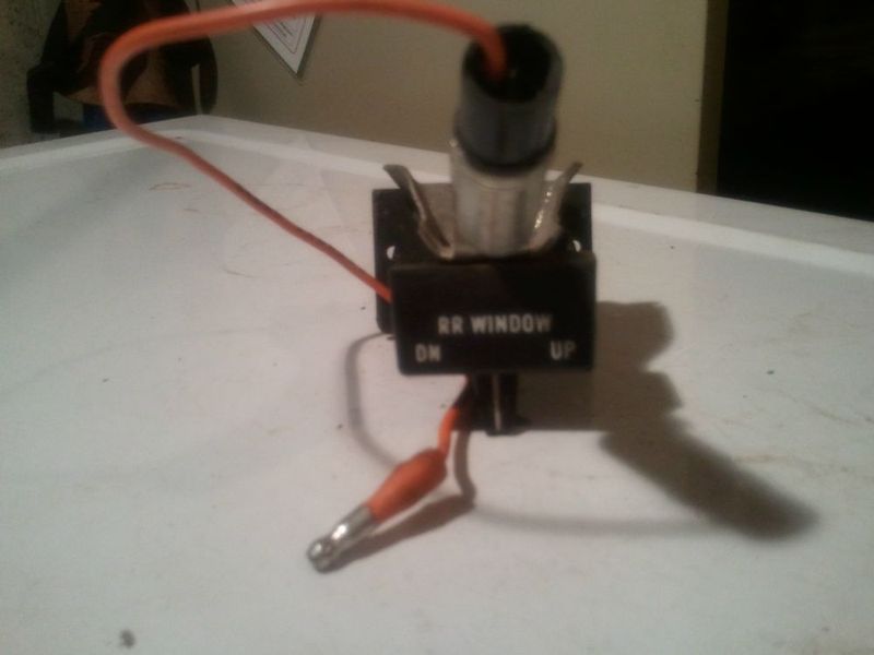

YY1 here is a pic of the wagon door window switch which is the same general construction as the rear defog switch and fits right into one of those three spots on the bottom left dash.
I figured.
thanks.
Now that I think about it, how could you have all three?
if you have a wagon, you probably don't have rear defrost.

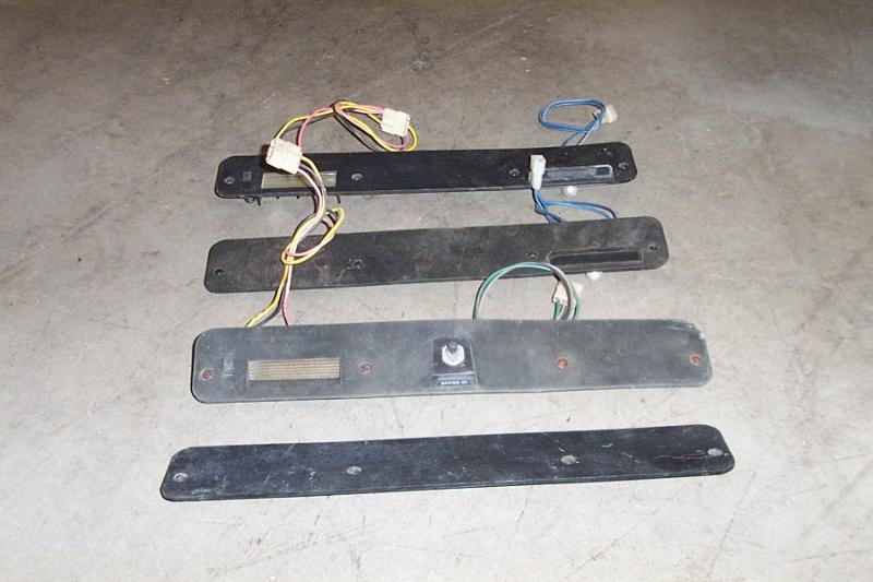

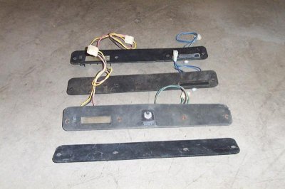

There 4 filler panels. The Fasten Seat Belt light started in 72. Some say late 71 but out of the over twenty 71 B's that I've owned including late ones none had the FSB light.
The map light and rear speaker was an option for all 4 years.
71 blank
71 w/ map light
72-4 standard w/ FSB light
72-4 w/ map light
The speaker switch can be added to any of them.

Sorry I forgot to get back last night but looks like moparmarks got ya couvered.
The Satty dash I have only has the seatbelt light but my chargr has the seatbelt and map light as well as the speaker fader.
