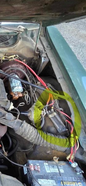

Has anyone seen this or know what it’s for?
Yes! SS22N.
Thank you:thumbsup:

If that car has a trailer hitch it's for the trailer brakes. Adjustable reostat for brakes.
