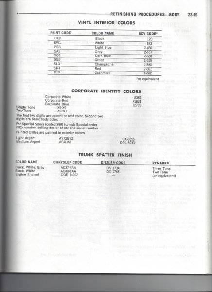

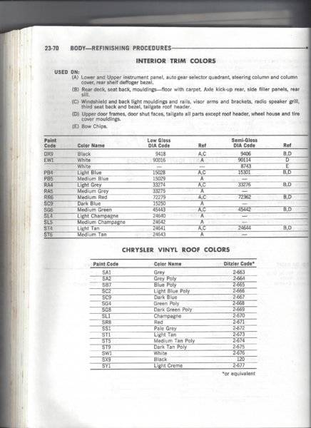

Went to the garage to dig out my '79 FSM and look for paint codes for you. Here's what I found, hope this is what you need. (I had the same DLR4 interior on my Magnum, should be the same for the 300).

OK I am embarrassed to say I never even looked in my 79 Chassis Manual.....DOH!
Thanks for the assistance! Looks like the color on the vinyl is SR4 which lines up with my broadcast sheet so now the question is.......Is the R6 formula close enough to R4 on the vinyl?
I figured the paint dealer could whip up a batch of the R4 with that UCV code? Maybe not that simple, I don't know????????
