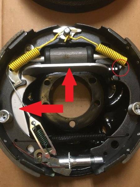

Not that big of a deal - just make sure they're for 2-1/2" shoes as they do differ depending on shoe width. Try to find a set that has ALL the hardware - including the two parts the arrows are pointing to. Complete assemblies run around $100. (US) but if missing those pieces you'll be spending that much more !!
Any idea where a person can find the complete set with all hardware like the picture above, tried Doctor Diff but they have none currently.
Don't know of anyoe selling complete "loaded" units. Putting them together yourself is no big deal. Shoes kits and drums are all available from Rock Auto or Canadian Tire. Good used backing plates are out there. Supports and levers are sold new through repro guys.
