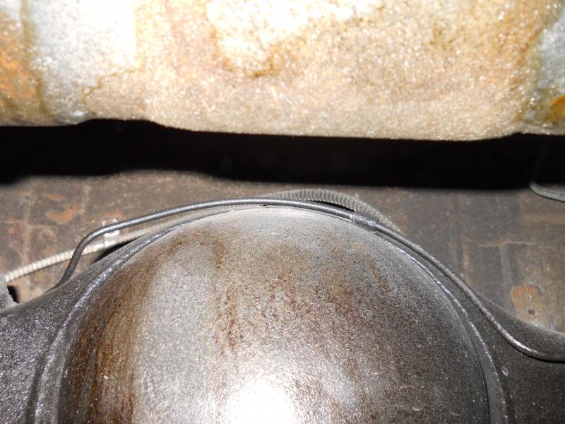

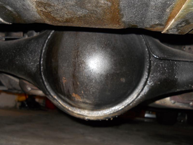

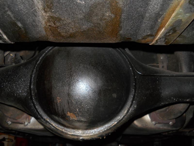

I was tooling around on my roadrunner and took a picture of the rear diff. It looks like an 8 3/4. I'm used to seeing a drain and fill plug on the back of the housing. I'm not see it on mine. How do I drain and fill this thing?
There is a plug on the passenger side of the diff housing, square type head, you will have to use a suction device to get the old gear oil out, then fill to just below that opening. Only other option is to separate the diff from the axle housing, which I don't recommend, as its a lot of work and you have to pull the axle shafts to do.

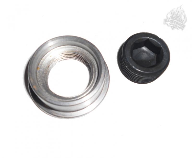

I did what 1970GTX recommends and worked out great. You don't have to worry about shavings getting in your housing cause once you drill through the oil will pull the shavings with it as it drains.

I've seen that before anyone have any issues with that mod?
How long / how many miles since you did it eagleone?

But that drain plug idea is "genius" as my Son would say. You most def would want to use a flush allen plug screw if you go that route, so it will not be damaged with a floor jack.

That's what I was thinking when I read it the first time! Looks like the one in the article sticks out and would be wacked or shoved in or damage threads by jacking up from the center section. I'd still be interested to hear feedback and would probably do it with the flush mount allen head plug.

Just be careful if you drill out the bottom. The metal in that area isn't exactly real thick so there's not going to be a lot of threads and the risk is there for over tightening and stripping it out.
yea..what he said above...personally, I would not drill out the housing...suck out the fluid & refill it...done deal
Also had that thought too Cranky. What it you build it up little off center then drill through that and use the flush plug?
Fluids been in the diff almost a year and I've got maybe 400 miles on it. As stated I was real careful tapping and didn't over tighten the pipe plug. No leaks, no problems
