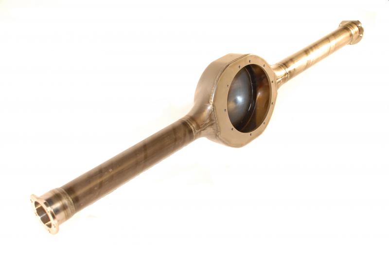

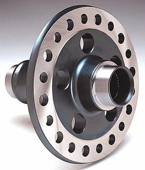

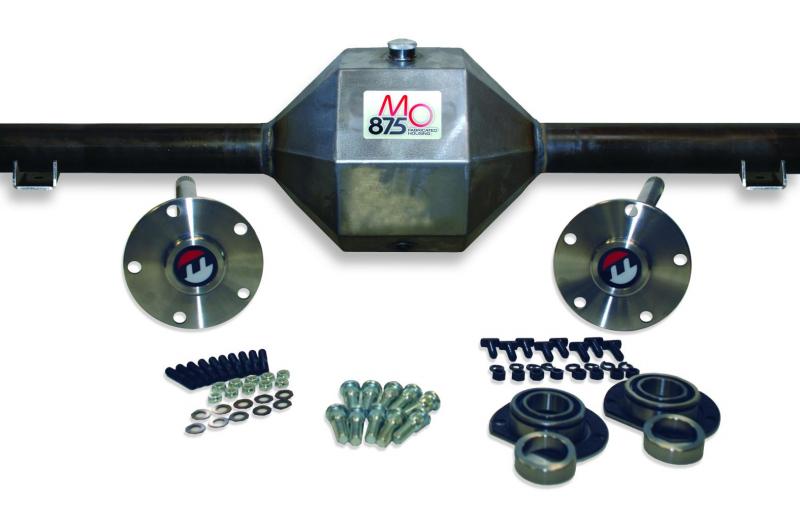

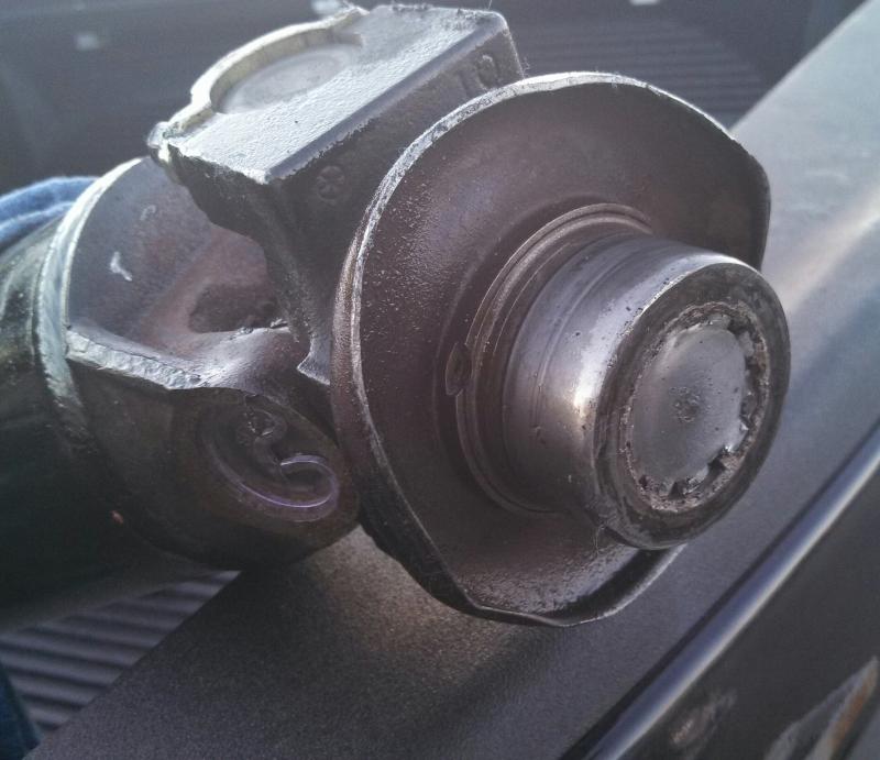

Yup, that's where the pinion will usually give up the ghost. It doesn't matter what case it is from the 41 to the 89. They all use the same size yoke. The 89 might have a little less pinion gear deflection because of it's size but basically has the same strength at the yoke.
