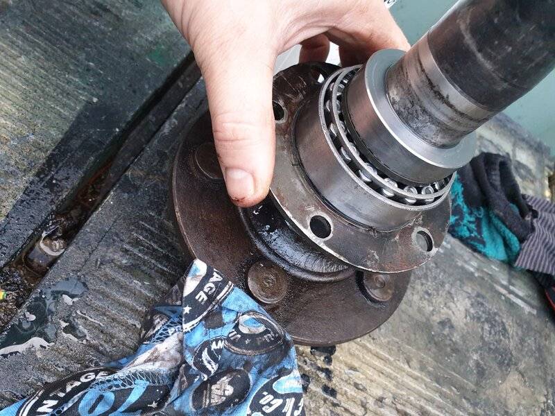

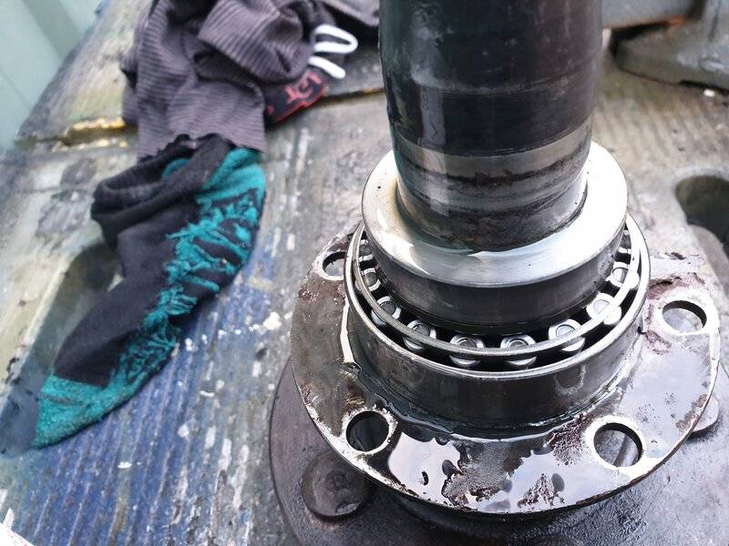

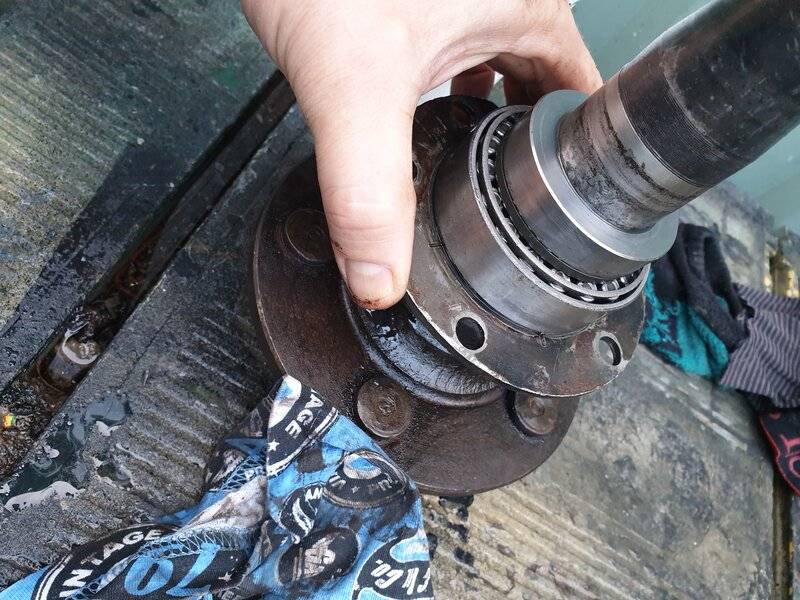

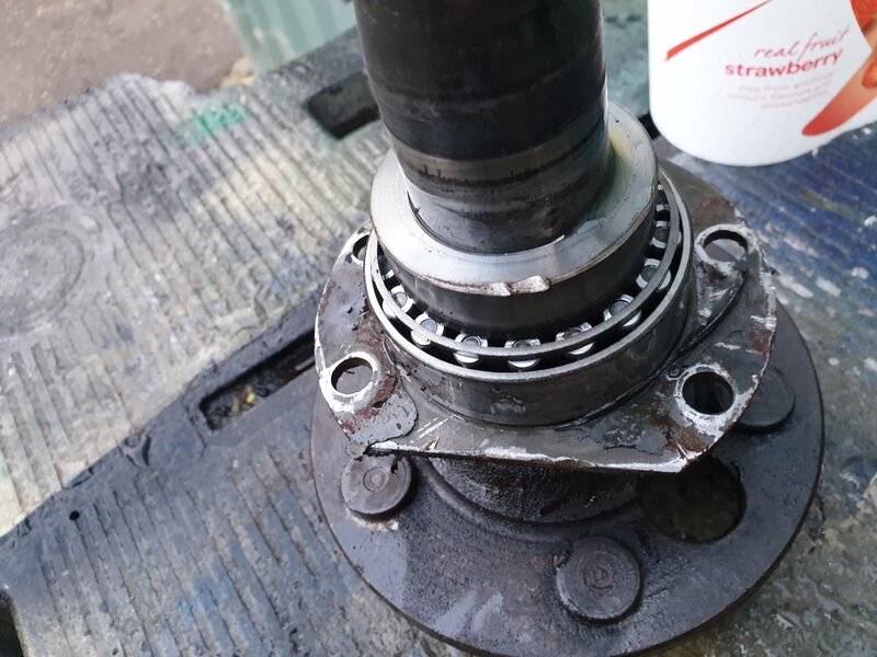

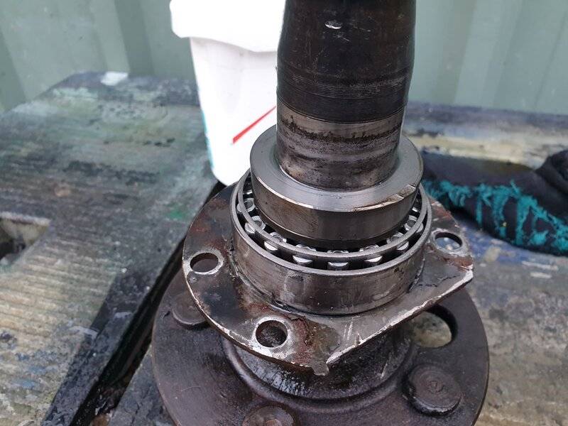

So I pulled the axle out and there's a few notches in the collar (as per photos). Maybe the hit it on instead of pressing it on? Does this need to be replaced in this condition? Also regarding the bearing cup and cone - are these meant to have a lot of free play, both in and out and up and down or should they be a tight fit to the shaft? In the bottom 2 photos below you can see how much they move in and out. Someone has tried to fix this before, there was black silicone sealant all round the retainer.

The retaining collar is likely fine, just got whacked or installed with something that left a mark. New assembly is usually done in a press.
Yes, the tapered roller bearing has a good bit of play without the flange bolted to the axle. Like Fran said in post 4, there's an outer seal pressed into that flange, under the bearing. It's important for keeping oil off the brake shoes. Otherwise, you're replacing shoes twice. The bearings need to be well greased - and NOT over greased where it pushes past the seal- when they go in. Silicone isn't needed with good seals. The downside is if you need an outer seal, you need new bearing also. Can't remove them without destroying them. If they're old or may have ran without enough grease, the choice is easy. A bad axle bearing has a distinctive sound, usually noisier when weight is on that side of the car.
Your brake shoes may be soaked with grease or gear oil. Buy new ones, as it's hard to get oil out of the lining.
your inner seal is done -- it keeps gear oil off the bearing (which is packed with grease) and your brakes -- if i was you i would replace the 50 year old bearings and the outer grease seal ( in the bearing retainers ) -- your seal surface on the axle looks rough ,, clean it up as any rust / pitting will not allow the inner seal to do its job -- if it the seal surface does not clean up a stainless steel repair sleeve ( speedy sleeve ) is available and can be installed so you have a smooth surface for the new seal to run on.--- make sure when you install the new inner seals you get them deep enough into the housing so your axles will seat -- there is a stop lip in the housing end the seal will bottom out against -- yes the bearings have that amount of play that is why you have an adjuster on the passenger side to set the end play on the axle bearings (.008-.012 )

I imagine someone used silicone to replace the foam gasket I mentioned earlier. There should not be any gear oil in the bearing cavity. When repacking, wash all the old grease out and pack in the new grease (I use two fingers to work it in between the rollers).

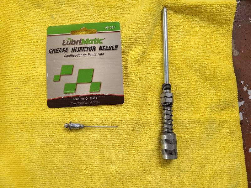

Any time I pull an axle I always add grease before I reinstall. very easy to do with a couple of grease gun attachments.
