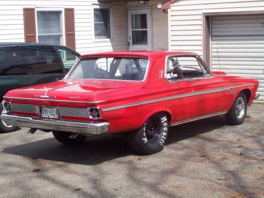

The only thing I can tell you is I put a complete drum to drum rear from a 65 B-body in my 63 Sport Fury and it fits good and everything works great. I also use a 1970 type 727 trans and went to a standard slip yoke on the driveshaft and eliminated the ball & trunion setup. Ron
