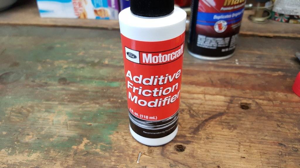

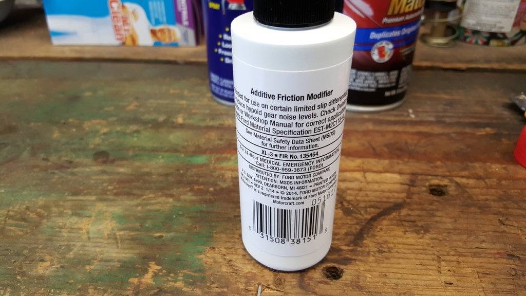

View attachment 510503 View attachment 510504
All the years I've been building rears, I've never seen this happen. It might work on one that's close to being worn out but it's not a cure all. The additive is mostly an anti chatter modifier. Heck, I've even used STP in one where nothing would make it quit chattering but the STP did.....
