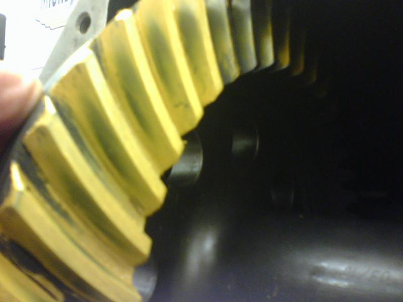

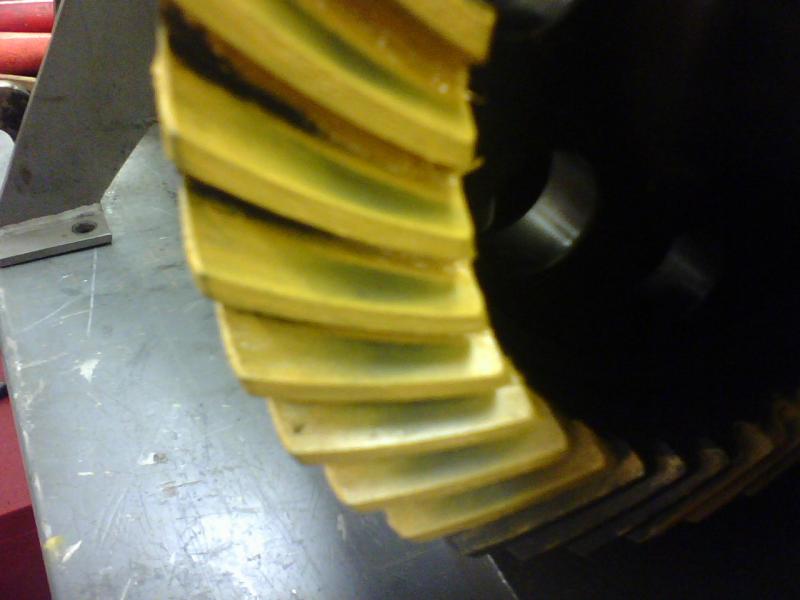

Once noisy, always noisy. I have found steep (4.30-4.56) Richmond gears to have slight whine during a "float" condition. That meaning neither accelerating nor coasting. A 3.23 should be quiet. The problem arises with used gears being swapped to another carrier. If the pinion depth and back lash aren't what they were in the old carrier it will generally be noisy. Reading a pattern on used gears is a crap shoot at best. ideally you should see this.

Doug, try painting the pinion gear only with the marking compound and then spin it through and see if you don't like that result better than how you're doing it now....
