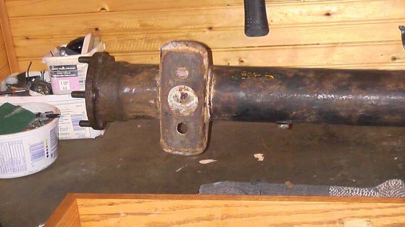

8 3/4 with 2 perch holes and 1 big 1

not sure witch 1 to use little confused, the 1/2 hole has always been right in the middle,as you can see there is 1 big hole.
The big hole centers the big rubber ISO mount used on '73 and later cars. I've just welded a spacer in the big hole to center the axle on the spring center bolt. Sorry I don't have one available for a pic.

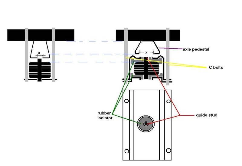

Don, here is some stuff to think about. I found this years ago doing some research on 8 3/4 housings, so I put it in my Mopar folder just incase I needed it in the future. It was on one of the Mopar websites years ago, can't remember. You can thank fellow member Nacho-RT74 for this information .
-axle pedestal are shorter on 73 and later to compensate the extra height added by isolators and clamps
-Guide hole is wider on 73/74 to fit the isolation guide.
-then if you replace spring be sure:
-Stud Guide doesn't have the extra bushing to fit inside isolator. 73/74 springs have a metallic bushing or cup attached directly on guide stud/bolt to fit inside the isolation pad. Extra info: Not sure about this but I have found 5/16" stud/bolts on non isolated and 3/8" guide stud/bolt on isolated springs with the bushing, I'm sure about the last but unsure on the non isolated are 5/16, since my replacement springs were made locally and found with 5/16" guides.
-front hanger bushing hole is the same size than you spring hanger bolt. Later ( 74 for sure, some 73 maybe since I have found both sizes setup on several 73s ) used smaller bolt to fit bigger isolation bushing on same outer diameter.
-and WILL NEED to change the lower plate ( where shock bolts ) to match also between the guide stud/bolt size and hole on plate without isolator

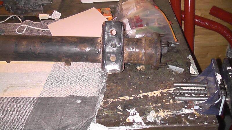

well i like the washer thing, got a hold of a mopar dude that will weld in the wahers in thanks for the tip.
looks like you might get a slight rear lift out of the deal
the pin shouldn't be that big of a deal
i can get a washer made up, need to know what size the spring locating pin is 1/2 dont know .
no more big hole, also call my mopar parts guy who told me the size i wanted case closed.
what size did the leaf locator hole end up needing to be? I'm getting ready to buy new leaf springs for my 73 roadrunner and I want to get rid of the ISO's. I will definitely weld in some washers and order 72 springs.
1/2 inch the shop that did it did a perfect job.
Does your car have a rear sway bar? I'm wondering if I'll have to weld a washer into my sway bar bracket as well if I go to 72 springs. Is there a locator pin in the top and bottom of springs?
no sway bar hear,yes there is a pin top and bottom.ya should put the sway bar back for sure.
