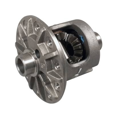

This is what mine looks like, on summit they call it a sure-grip but for an 8.25 rear, are all spider gears for the 8.75 interchangeable?
There is a unit similar to this one that is called a Trac Lock. There are clutches outboard of the side gears (side gears that are splined). My 9 1/4 rear in my Durango has one and imo, it's crap. It's also hard to install new clutches in the one piece case without the proper tools. Also, the spiders in all 3 different diffs for the 8 3/4 are different. The cone unit (Borg Warner anti spin Sure Grip) spiders will not interchange with the Dana style clutch unit (Power Lock) spiders and the open diff non Sure Grip spiders are not either. Cone type rears can be machined to work well again so long as someone took it out of service when it quit making both tires spin. They will not last for very long if they keep using them as a one wheel peel rear end.
