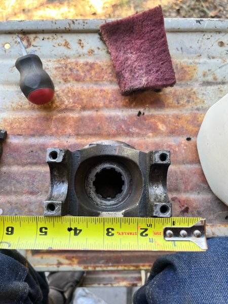

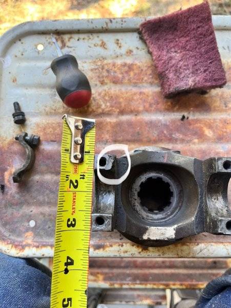

I'm replacing a leaking pinion seal/grooved yolk off a 742 center section. I believe it's the larger yolk size. Each of the four surfaces has issues; some I can file down to even out, but one corner is pretty badly marred (circled). Either I order a new yolk from Dr. Diff or I'm thinking I can just drill the holes out and throw in u-bolts, which people seem to prefer anyways. I guess first am I missing something? and if not do you know if u bolts for the joints are available?

What does the seal surface look like? My past experience is that those yokes do not take well to a u-bolt conversion. There is not a lot of meat there for drilling and the back side does not have much room for a nut. If it were me I would get a new yoke, straps, and bolts and dont look back.
All you are doing is taking out the threads....but it is better to get a new billet yoke and get rid of the standard one. Thing is you now have a strong yoke and the rest of the rearend is still factory weak... not that the 8 3/4 is a weakling but it is not as strong as say a Dana 60 in stock form.....
Hey, sorry for the late response. Toeing the line between polishing a turd or doing safe and easy option is tough. I've decided I'll just fork out the cash and get one that I feel good with spinning at speed. I appreciate the input
