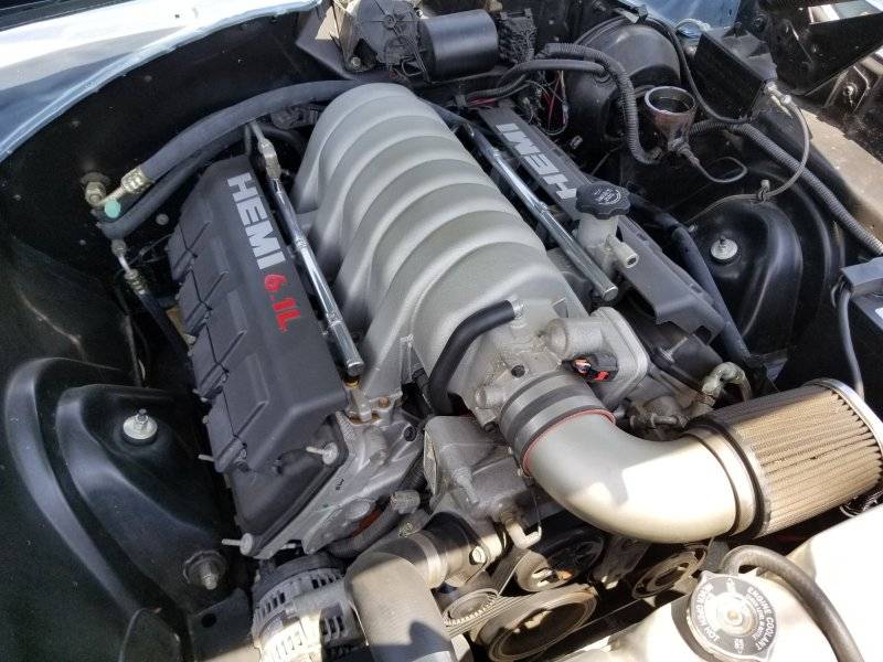

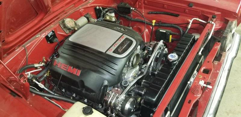

I know the Gen II Hemi looks awesome under the hood, as I have several. You can transplant the whole drivetrain from a modern Charger or Challenger and gain a little fuel mileage at the same time. Building a Gen II Hemi to 800-1000 hp will suck the tank dry in short order. My stock Hemis only average 10-12 mpg, and this one is more like gallons to the mile with only half or a little more of your wanted HP.
The Gen III Hemi can look awesome under the hood also.
