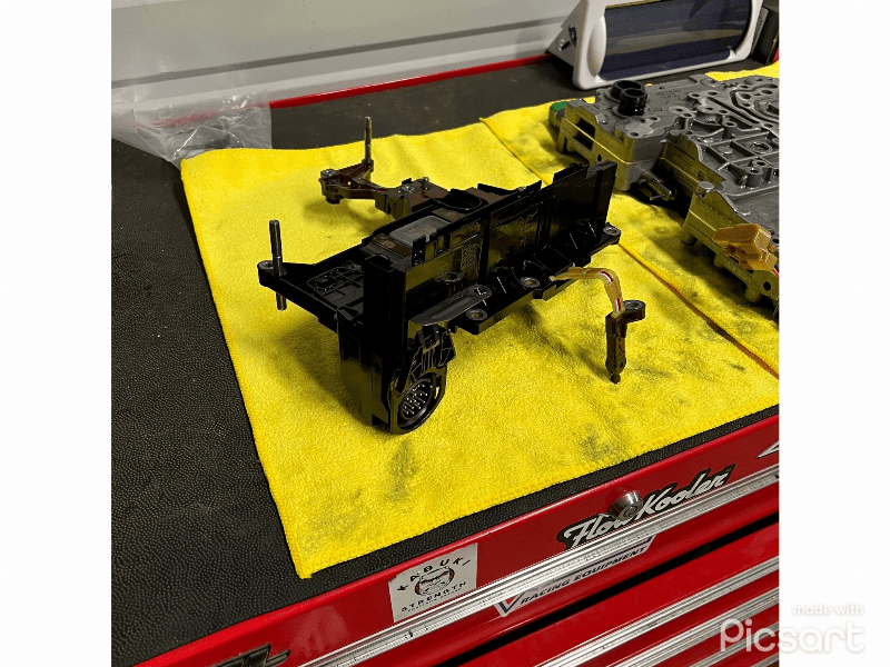

Since I'm running this standalone without any of the inputs from a G3 i talked to Russell over at Sound German Auto who walked me through what he provided and what i was looking for. He provides a TCM interface module that the inputs the trans needs to function, and flashes the TCM to look for those.
As such you need to remove the TCM to send it to him, which is on the back of the valve body
and she's out

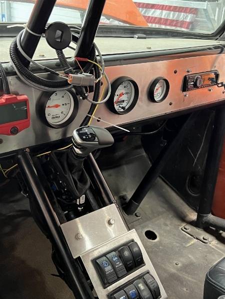

From there the only other part you need is the correct shifter for the transmission file you will be using. Even though i pulled my trans out of a 2019 ram i couldn't stand the knob shifter, and i wanted to have the manual shift option that the rams dont offer. So i pulled the console shifter out of a 2019 charger and had Russell upload trackhawk programing (due to mine being 4x4, most others would just use a challenger/charge file) that allows the use of the console shifter and 4x4
Excuse the rough install this was still during testing
I also opted for the digital gear indicator (the small black gauge wrapped around my dash bar) and paddle shifters, all options offered by Russell.
