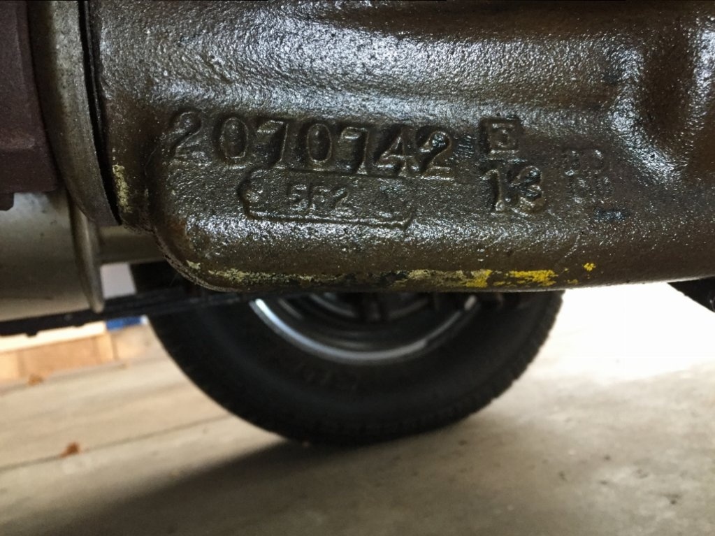

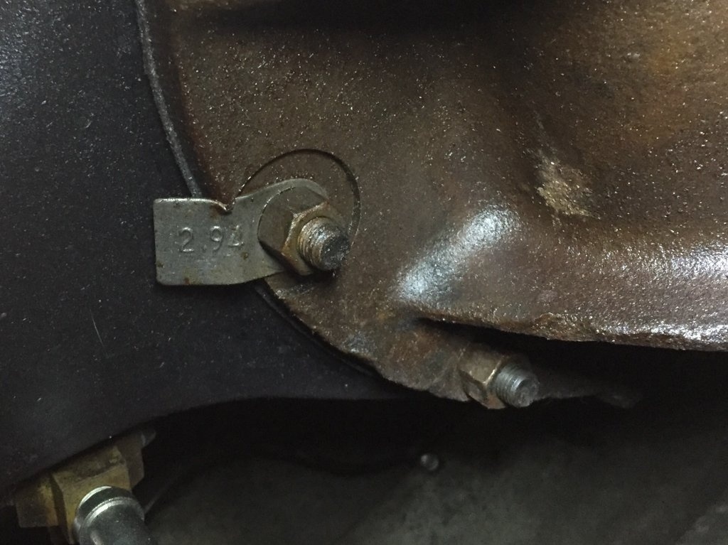

My car currently has 2.94 open diff in a 742 housing. This off season I was hoping to swap it out for something a little a taller for a little more "umph" off the line.
There is a local guy who has an open 3.91 in a 741 housing that I'd be able to get my hands on pretty cheap and was thinking it would be nice to try it out. Is there anything else I'd need to do the swap or will the driveshaft hook right up?

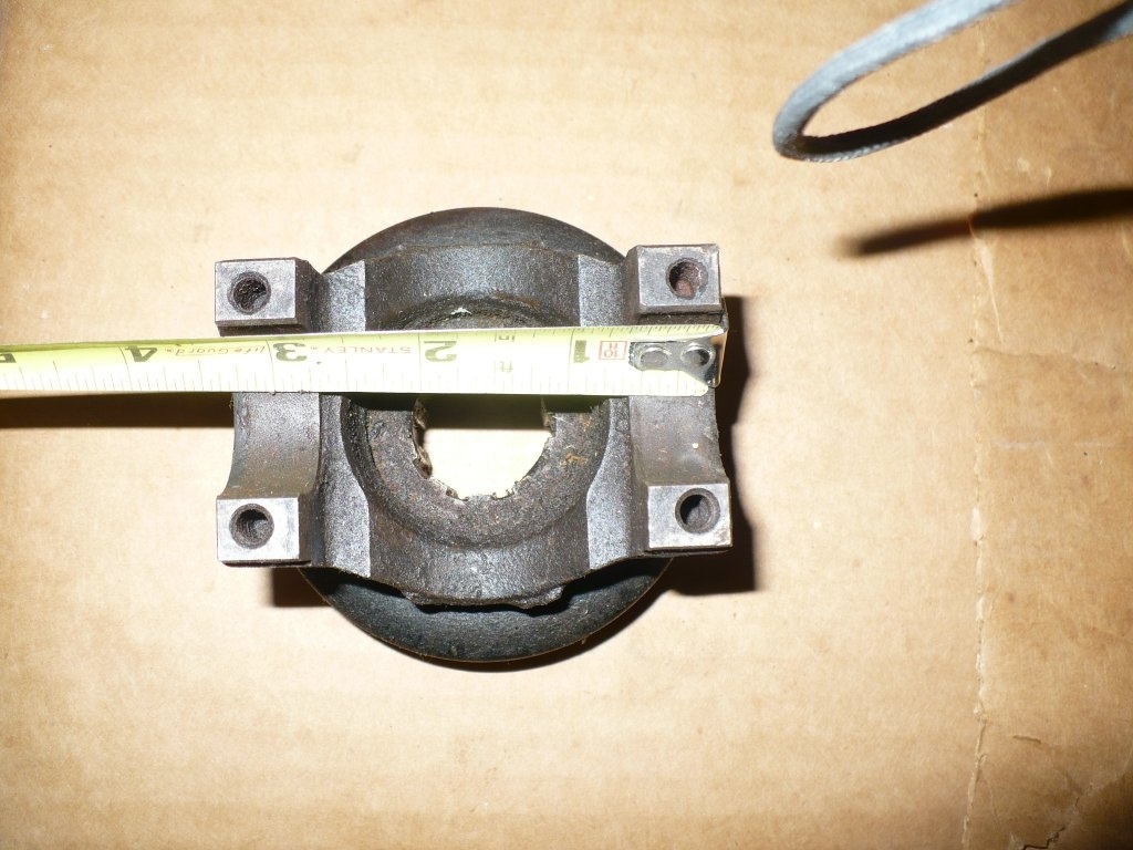

You need to compare the yoke/u-joint from the two third members. There are a ton of adapter u-joints out there. My bet is the 741 has a 7260 yoke and the 742 is a 1330. There are adapter u-joints for this combo. The picture is a 7260 yoke 3.25" appox. and has inside clips to hold cups in place.A 1330 yoke is 3.75" but has small tabs to hold the u-joint cups on the outer ends of the yoke cup mounts so the u-joint is 3.625" and 1.0625 cups. then there are other u-joints 7290 and 1350. I adapted a 7290 yoked driveshaft to a 1330 yoked Dana 60 by taking the 7290 cups off and putting on 1330 cups. You can find u-joint dimensions online.

Your 742 is in your 67 Satellite I assume. In 68 I think they when to the 7290 as there BB u-joint. Could be wrong. The 7290 drive shaft I wrote about was from a 68 Hemi GTX 4 speed I ran it but the shaft was to short to be right. I have a 66 Satellite it in my picture.
