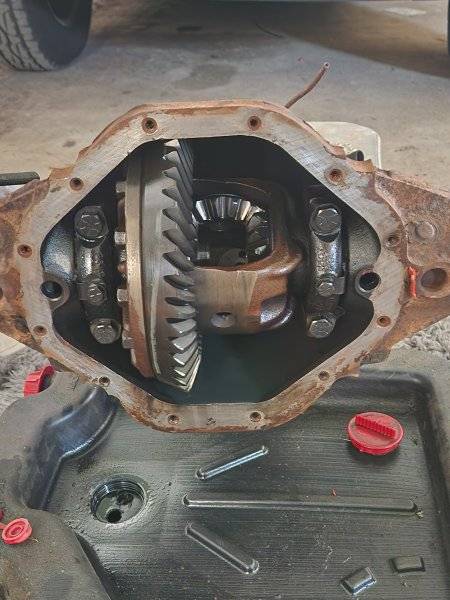

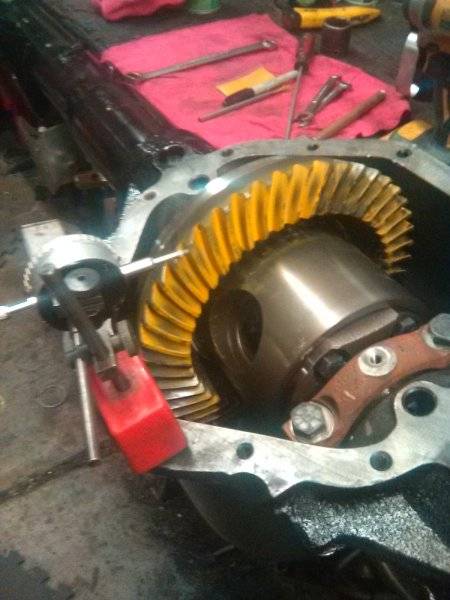

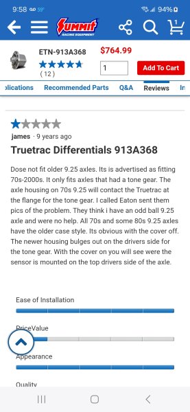

Hi I have a 1979 Chrysler Cordoba and just picked up a 9.25 rear end out of a 79 Chrysler 300. I want to mildly drag race the car a couple times a year. So an aftermarket limited slip is what I want. I really want the eaton truetrac, but there is a post on summit Racing that says it does not fit the earlier 9 1/4 rears that don't have the tone ring. Please see attached pics and the difference between the housings. I believe the tone ring housing started in 84. Please let me know if any aftermarket carrier will work or is it possible to grind away some housing material to fit. Thank you so much
It lo9ks like you might be able to grind the case, but you'll probably have to use a later cover.
