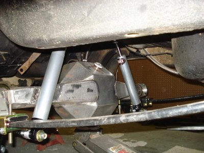

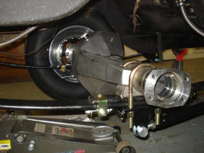

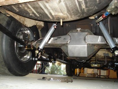

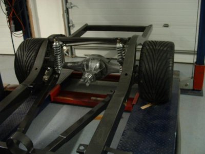

I did that swap into a 55 Chevy, tubbed rear and narrowed axle myself. Know and source your rims as some manufacturers are limited in their offerings of backset and you may have to adjust your width to what you can get. Custom rims after the fact can get very expensive! I also beefed up the housing with a back brace I welded in place, there are several kits you can buy to do this yourself. After getting full measurements and welding her up(skip welding) I contacted Strange and ordered Auburn plus correct length axles. I added a coil over, 4 link just to make things more solid which went according to plan also. All of these mods were tacked up and test fitted before I did the final 003.jpg welding. Pretty seamless but make sure of which 9" you are starting with, double check all measurements and know/understand which brake set up you are going with. Had even though of going to a 9" for my 69 Coronet, still undecided.

I just got done doing this on my 67 Coronet. I put my wheels I wanted to run under the car, set em up where I wanted them. Got my measurement and called up Moser Engineering and they built me a housing. I believe it was 53 1/2 from axle end to axle end. I didn't want them to put the perches on so I could figure out my pinion angle as well as center the housing. Stuff is not cheap though. If you have any questions or anything I can help with, please ask. I'd love to help. Also with the back brace... Something to think about is where the shocks mount up. Hard to see in the pictures, but I had to notch mine out so my shocks would be able to mount in the stock locations.
