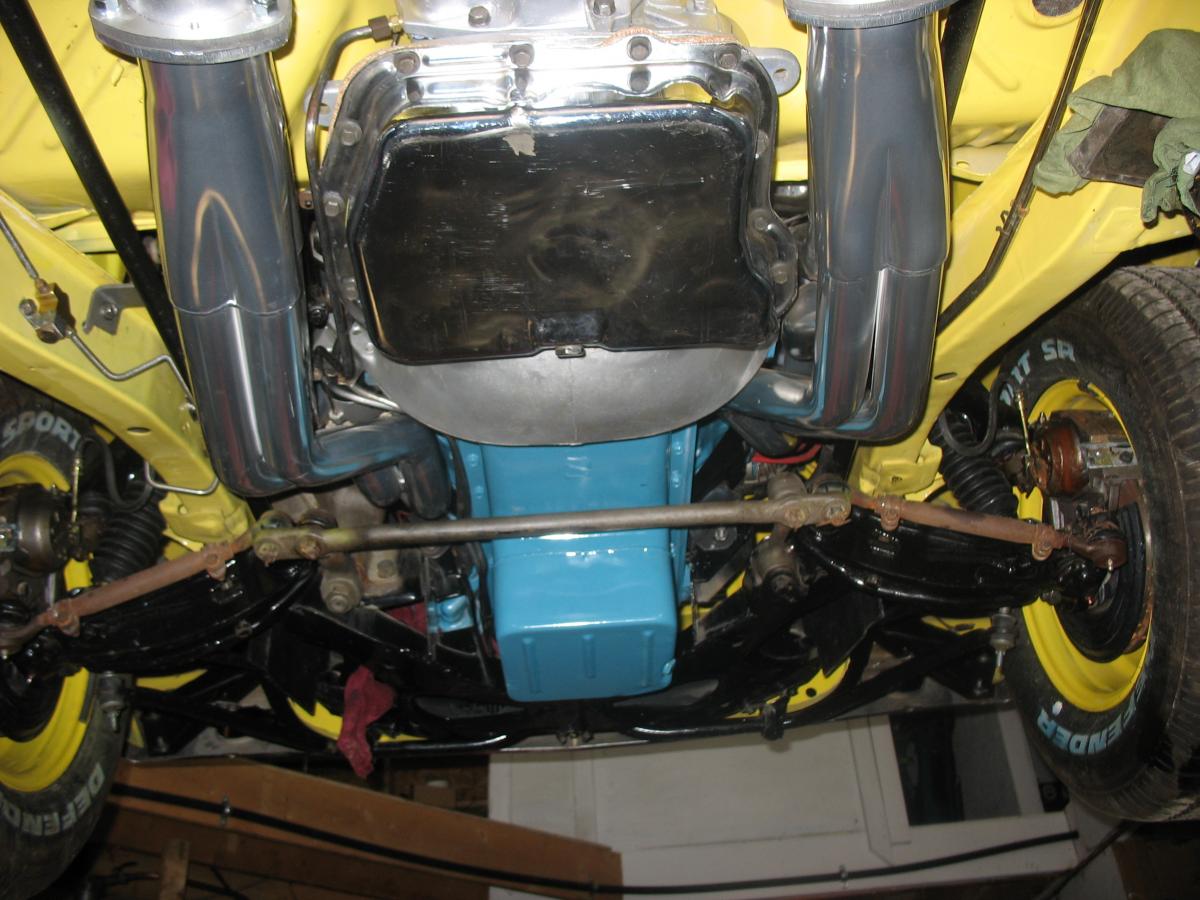

This is my Bee,used 74-76 A body set up,spindles on opposite sides so calipers hang to the rear to clear the front sway bar.
