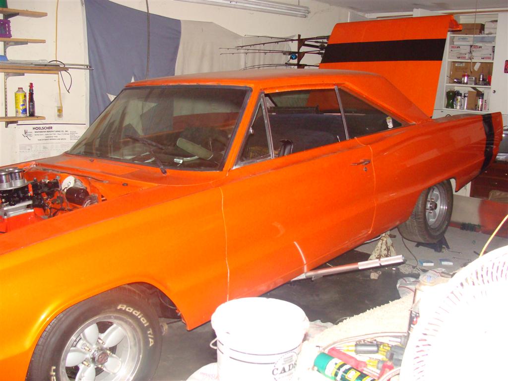

I rolled the bead on one side and wish i hadnt. Cause now i cant run the wheel opening trim. I have the old school wheels one set 8.5 with 235s and a set of 7 inch with 9 inch slicks. Motors around 600 horse with 4.10s so i need to stuff as much tire as i can.Heres the car and wheels.

BTW, daredevil, I generally don't like tail stripes on body styles that aren't supposed to have them (or HIP colors on cars that are pre-HIP era), but that is one sweet Coronet.
