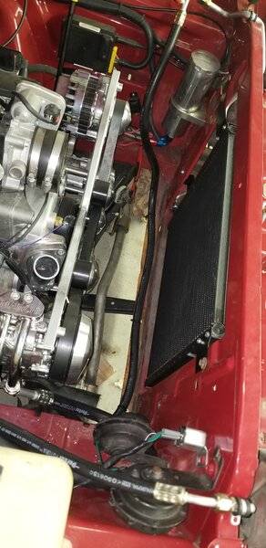

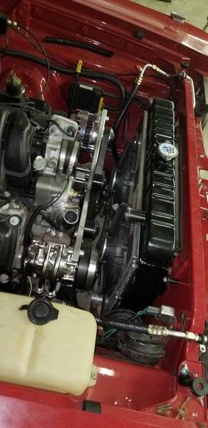

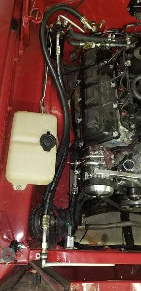

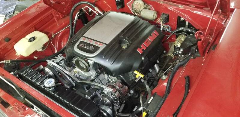

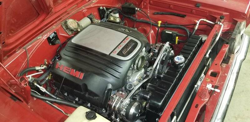

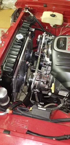

I have been working on adding A/C to my 67 Satellite, 5.7 5speed conversion car for some time. Other projects have been in the way and still are for that matter. I added a March Pulley system to relocate the alternator and A/C compressor for a cleaner installation. I'm using Classic Auto Air system with some modifications due to the 5.7 Hemi and relocating the compressor so I didn't have to notch the frame for clearance. I had to change radiators from the one I used on the initial conversion to the 5.7, due to clearance problems with the pulley system. I now have a Griffin with dual slim line cooling fans.

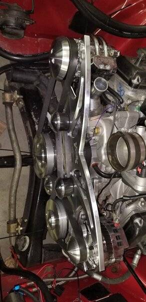

Like that set up. Found out that my belt is hitting the compressor bracket to day on my classic A/C set up. Look's like I got to grind on that bracket. Found belt dust on the water pump. NOT GOOD.
Looks good. I bought the universal condenser and hose kit. Then I bought the Chinese knock off hose crimper so I could put things where I wanted.
Some of the hoses in the kit I specified from Classic Auto Air were left uncrimped for placement purposes. I also had to visit a A/C supply house to get a different angle on one of the fittings. My brother has the Snap-on hose crimper, so it is currently borrowed.
Looking good Jerry! I installed A/C in my 68 RR project as well. I think it will make driving these cars much more enjoyable, remembering how it was in hot weather years ago. ruffcut
Say ruffcut having to shave the compressor bracket some on my runner. The belt was getting eat up by the bracket. Thing's are really close their. It is the belt for the fan blade and alternator. Took the grinder to it today and painted it. Will install it all back tomorrow. Just some thing to keep an eye on. Other than that happy with the install. But some times we have to tweak a few thing's.
