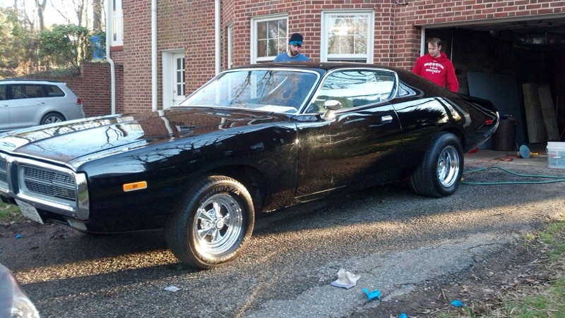

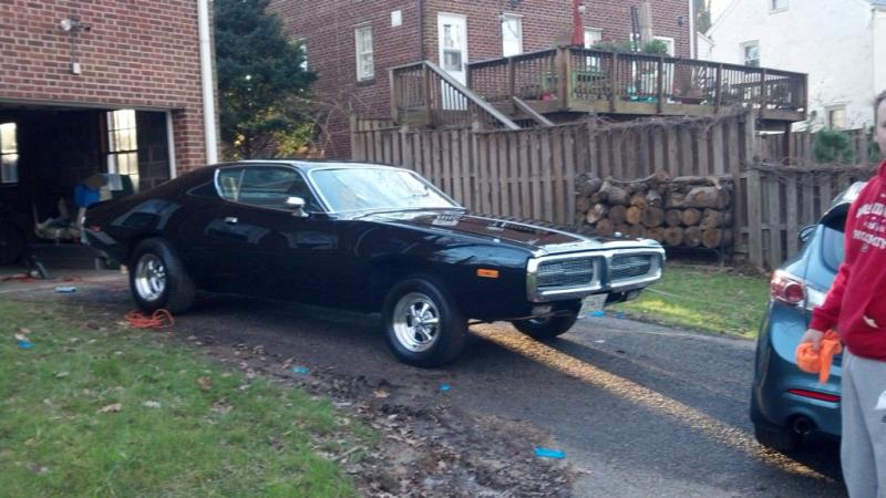

Hello All-
I am getting so very close to "finishing" my 72 Charger SE. Once the interior is finished, I plan on ripping out all the vacuum hoses and the A/C to 1. Help her breathe better and 2. Not let the A/C rob power from the engine.
Does anyone have advice on doing this or recommendations on where to look? I am trying to clean out the engine bay of all the old lines and make it look better little by little.
The electrical is almost finished and it is going in for upholstery in the coming weeks.
