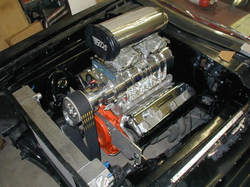

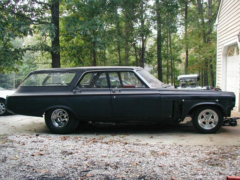

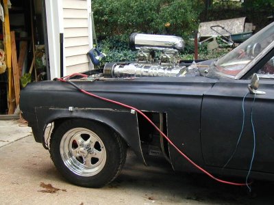

Here's a pic of a recent AFX built by me, using C-body Imperial bars, since the "ever elusive" D-body Imperial bars you dream of were not available during my build. Perhaps you could pull a set of those D-body Imperial bars and load up some pics with a tape measure behind them - OR, even better, how about some pics of that build of yours ?
Here's mine. Now let's see yours...

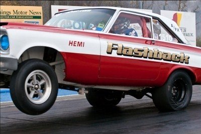

HI take a look at afxer .com build pic. of my awb plymouth using 51" bars that needed to cut down to fit the hex ends. and if you are doing a 1510 car you do have to lower the point where the torsion bar connect to cross member "it need to be lowered. All the factory car were that way. This car has a k frame an controll arms. You can see how low the torsion bars are.

I have a dumb question for southernman! No offence intended but why did you move the frt. wheels forward and not the rear? Or haven't you gotten that far in the project.I'm just curious is all.
No offense taken, and I think you have a cool car there. I'm just not a "true" AFX fan (no offense). More on that below.
The 51" bars are correct for an AFX build and have the correct spring rate, hex dimensions, etc, but I didn't have a set, so the C-body Imperial bars, which are 5" shorter then TRUE AFX bars (with much larger/stiffer bar dia's) were used - and I understand that others have used them as well. However, the 51" bars do not require receiver tube/cross-member modifications, whereas the shorter C-body Imperial bars require cutting down the hex to fit the B-body receivers, and the receivers must be removed from the cross member; cleaned up; relocated 5" forward; re-welding; and considerable bracing added. Or, you can simply custom build your own cross-member and drop the bars to replicate the AFX stuff. Either way, it's a lot of work.
Again, it's a good/fair question. I didn't move the rears because I was shooting for a "stretched" dragster look, and I was not really interested in replicating the AFX setup using a station wagon. In truth, I (personally) don't like the look of the AFX'ers with rear wheels moved up and their nose-high stance, though I love that era of cars. I like any car that has the front wheels pushed forward netting a positive weight bias with engine setback - and a slight nose-down stance. It just scream "dragster" to me...
For that reason, I simply moved the K-member; shock towers; all sheet metal; firewall pushed back and flat; suspension; and receiver tubes to move the wheels fwd 10" - while maintaining the clean rake of a late model pro-street car. The 10-71 blown Hemi is just icing on the cake. One other thing of importance: At 10", half of the K-member modifications are "solved" using existing holes, leaving only the other 2 hard mounts to be installed. It requires opening up the frame; welding; and sealing it back up. Those of you who've done the mods know what I'm talking about - and it's also the reason Chrysler Engineers settled on 10"...
And, Steve, I never said I moved my cross-member: I stated the receiver tubes have to be flipped with a C-body bar and rewelded - unless you choose to drop and custom build a crossmember.
So, in summary, I modified the front suspension to achieve the "look" I wanted. That's all. Thanks for asking.
