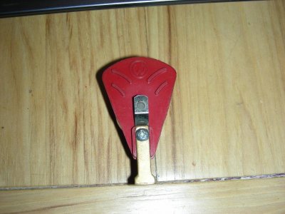

Good advice, last time I had the cap off I thought the rotor button looked funny but it was still making contact (no carbon). It's a Summit brand billet distributor (magnetic pickup, mechanical adv.) and I already checked the gap in it. Today was my first day of putting some real miles on it so I'm early in the diagnosing, I'll try all that I haven't already but I've covered most of those bases. What heat plugs do they usually like??? It's a moderately built 456" with a 501" lift cam and a Mallory 6AL ignition for ignition. Thanks, I'll keep taking all the tips I can get and then tear into it tonight and try to get it resolved.
When I say "funny" I mean it was very squared off looking, I'm used to the buttons being a little more rounded and spring loaded but couldn't tell if it was supposed to be that way or not. I've got a pile of factory Mopar distributors laying around that I might try out.

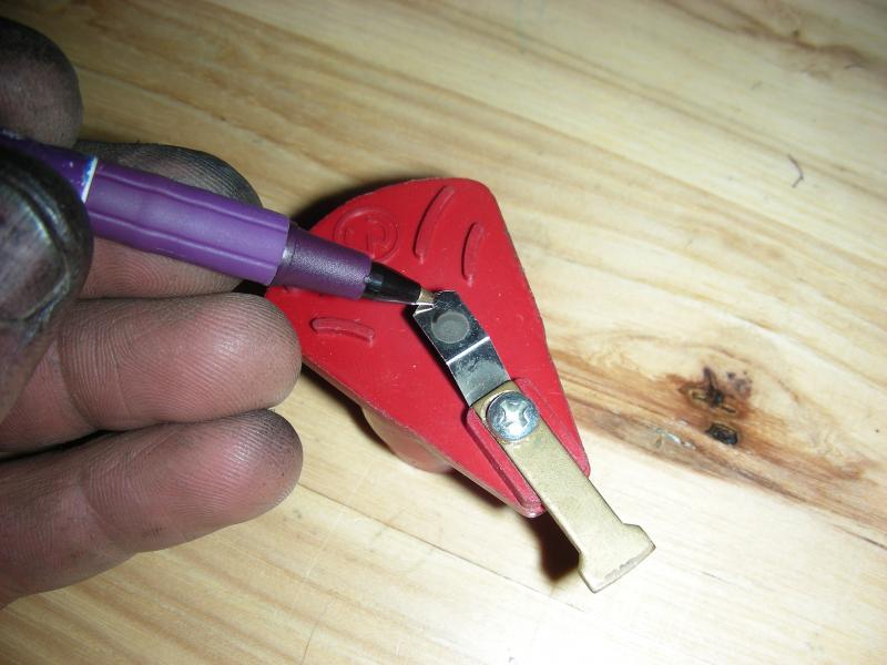

Think I found it but unfortunately I'll have to call Summit tomorrow and see how quickly I can get another because I really don't want to have to drive up there again. The button in the cap that I mentioned earlier is showing a little more sign that it isn't right now. The button looks like it may have gotten the tip broke off leaving a squared off edge, look where I'm pointing on the rotor and you can see a very small half moon shiny spot just outside of the dark circle. It looks to me that the button is barely contacting the rotor with only a little of it's now squared off edge and then arching and making the center dark. I'm hoping that they used a popular cap on this distributor and it's not a Summit only cap so I can just pick one up locally. I did test for arch's, vacuum leaks and loose connections.......all good. I'll let you know once I get another cap if that does it. Thanks DSCN9412.jpgDSCN9410.jpg

Thats a Mallory rotor.
Very good Wedge A+. I was a little worried when the Summit sales tech said "that distributor has been discontinued and we (Summit) no longer offer the cap and rotor) but then he said it's just a Mallory unit so he's shipping them. It is good to know that for the most part all of Summit's brand name parts are sourced from respected manufactures like Mallory.
