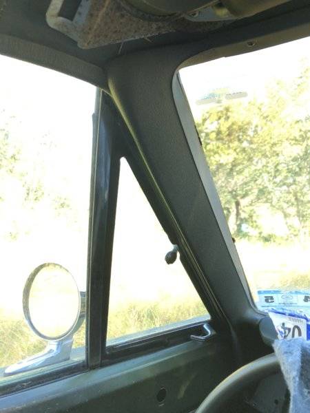

anyone know if the A pillar trims from a 4 door satellite fit a 2 door satellite in the 68-70 range?

Thanks guys. I actually mean the interior trims, as pictured. Wondering if they’re worth anything to a coupe or hardtop owner, as they are in nice shape.
Pretty sure they are different. Windshields are different and so are the wing vents and door glass.
No.. they will not fit a coupe or hdtp, but they are worth something to a 4dr or wagon owner.

Thanks Dodge33! The windshields are both awesome, as are all the windshield and window chromes, and the door glass is pretty good. If you think there are people who will actually benefit from these parts being in such good shape, let me know and/or send me a link to where I can find those people! Ha

The front windshield will sell..just have to post it here, and give it a little time as people are
alway's looking. As for the front windshield stainless trim, all the pieces are 4dr, wagon only,
but the two lower pieces at the windshield base (cowl) will work on a 2dr hdtp or post car. The
rear window.. not so much, (give it time) as there are a lot of them out there, floating around
still. If it is tinted, probably worth saving. The door glass isn't so desirable, unless you need one.
The front door window regulators are worth something, again, if you need one. The drivers side window regulator more desirable (they get wore out from lots of use). Hope this help's you some. Dodge33
.....but the two lower pieces at the windshield base (cowl) will work on a 2dr hdtp or post car.
Not unless you trim them. They are longer in length. I know this from holding one from a 2 door car and one from a 4 door car in my hand at the same time.
