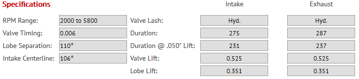

I'm looking at the Comp XE275HL, which carries a lobe separation angle of 110. I know what LSA is, but what effect would grinding this profile on 112 have in a 440, 9.25-1 compression with aluminum heads/intake and 2500 stall? I understand it will affect the overlap period but what does that mean in terms of power output/valve timing/idle characteristics/sound etc? Much appreciate getting edgycated on this subject thanks!
A wider LSA means a smoother idle and higher vacuum. It usually also means a lower rpm power peak.

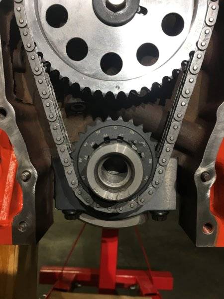

Well it ain't no blown hemi!:D:D:D Haha but it was okay, fun enough for the street even though running on spinny-spin Coopers. I thought it could be better...Then I got into it and discovered some issues. Long story short, it was about 8.8 on the compression, with failing rings oiling the chambers pretty bad and a cam retarded by 6 degrees..only about 3000 miles on it..yeah YIKES! Getting it taken care of as we speak before I go into mopar-driving withdrawals. I wish I had the means at the moment to stroke it out or at least build a new rotating assembly, but it is what it is for now. Just doing a little milling on the heads to at least be up over 9 to 1, cleanup, re-ring and re-hone the block as all the bearings are cherry. Cam will be properly installed and degreed (by me this time), should be a tad bit rowdier than it was. It sees lots of miles so it doesn't need to be too pumped up for me. (With all that going on it was still quicker than these 5.7 challengers..and I don't hook for jacksquat!)

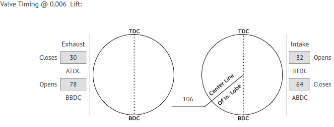

This could open a can '0 worms, but you could grind it on 112 lsa, and then given the low CR consider installing it back up around 104* ATDC
The wide verses narrow lsa is a compromise and is somewhat dependant on the goal of the owner. But when a guy is trying to balance power, street manners/low speed torque, and low compression, my gut tells me smaller cam, tighter lsa, and advanced ICL is probably the overall better plan. But I really have no data or personal experience to back that up.
I run that same Cam in my 383/432 Stroker that I built last year
However 10.5-1 Compression - 195/200 PSI cold cranking compression on all eight
Edelbrock E Street Heads 75cc
Degreed it with help , and installed it zero
12"-14" vacuum at 700/800 Rpms - Very smooth and can set idle pretty much anywhere and running power brakes
Has the typical sewing machine sound at idle running the Comp lifters
Off idle , keeping the car straight anytime in the throttle with 275-60 rear tires is my biggest complaint LOL

For cranking pressure and very low RPM torque, the cams installed position (intake closing point) will have a greater effect than the amount of overlap be changing the LSA. The overlap will affect the idle quality, and how the poweband looks. Narrow LSA power band usually starts a bit lower, but peaks quicker, then falls off fairly fast past peak torque. Wider LSA power band is usually flatter, starts off a bit higher, but does not peak as fast or as much, and then power does not drop off as fast past peak torque.
THAT is intriguing...
You make a good clarification. LSA itself has nothing to do with the cranking pressure. It is the ICL. But generally the ICL tracks with LSA. Normal convention would have you install a 114° LSA cam in the 110° to 114° ICL range, and a 108° LSA cam in at 104° to 108° ICL range.......usually. So indirectly, with this convention, the cylinder pressure would go up with the narrower LSA. Certainly there are exceptions on how people might choose to install their cams, which was Bob's point.
