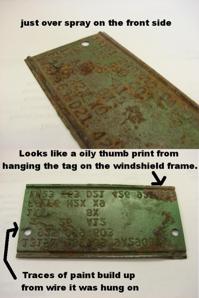

The A12 LR tags were bare metal or covered with a bit of overspray. The accepted scenario is they were hung from the window frame when the car was painted. See attached photo. I don't remember where it was from to give credit.
