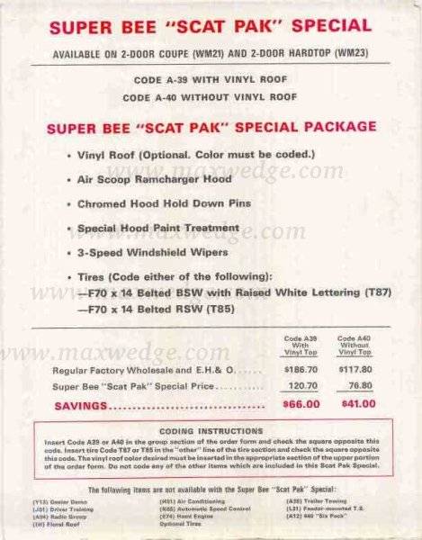

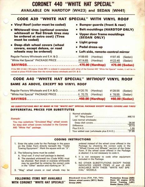

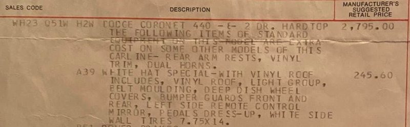

Those items would have come in any of the A39 packages, as applicable, in Darts, Coronets, Super Bees, Polaras, Monacos, etc. Here's what the Super Bee A39 pakage looked like on a window sticker.

Here's what the WH23 cars got with A39
