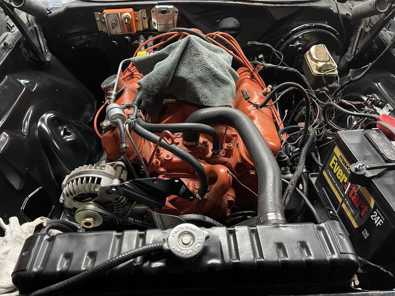

So pretty much done with the physical part of the install
I had a few remaining questions
car had a 904 before now has a833 od buy
will the stock 360 exhaust manifolds I had before work with this trans since now there is a z bar ?
what do I do with the neutral safety switch wiring from the 904 ?
what else do I need to wire on the a833 ?
what gear oil is recommended and how much ?
thanks and if there’s anything else I should know feel free to add
oh and this is on a 74 e body but I posted on that forum and everyone’s busy posting eBay links for e bodies for sale
85W90 GL 4, mine took over a gallon, some people will tell you synthetic but it doesn't work well with brass synchro's the reverse light switch is just 2 wire harness your auto might be the same ,I'm not sure on that I don't have any auto's and I don't think they made auto - standard specific exhaust manifolds yours should work
Cool thank you
I hope my lower rod (under the brace) doesn’t got anything I’m worried about that one
