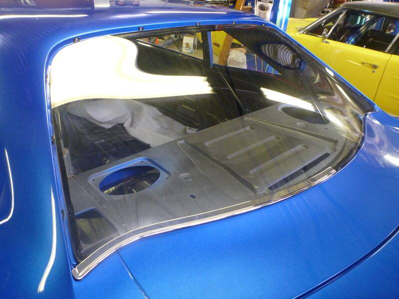

I'm about to the point of reinstalling the chrome trim on the windshield and rear glass (68 Net). I sure wish I had taken some notes on how I removed it!
Any advice on which piece to start with?... Tips?... Warnings? Thanks guys!
Lay it out and note any witness marks left from the original assembly. Usually the small intricate pieces go on first, especially if they go around corners like the top windshield corners. Look up/blow up photos of 68s on this site for detail.
Mike
Ok, the trim isn't seating. Are the clips not sitting high enough? Too much goo around the clips? I'm not having much luck here.
