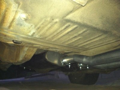

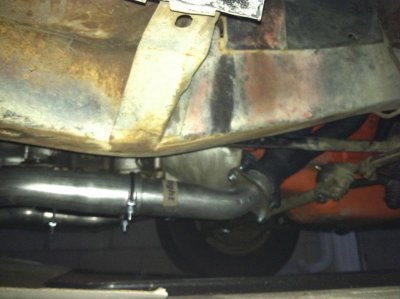

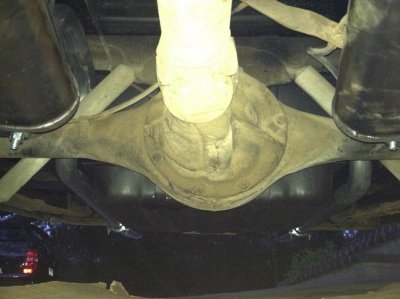

very nice , any photo's???
Some poor photos of a VERY NICE system. Couldn't be happier. I spent an hour last night not following instructions, called Accurate this morning and was told (politely I might add) to follow the instructions - Install the parts from the back forward! Seems counterintuitive, but it is MUCH easier that way. You'll see from the photos that this system (1970 Roadrunner, 383HP; Accurate full system; Magnum mufflers) is connected at the front to a new set of Schumacher Creative Industries Tri-Y headers. Again: Follow the instructions and it goes like clockwork. I did both systems (headers, exhaust) with the engine in the car, car on jack stands in the garage.
As has been mentioned here, this stuff IS expensive, but it fits, and even mates together, perfectly. Name another aftermarket product that you bought for a 40 year old car that fit without the slightest modification...
For header installers: I had to replace 2 of the manifold studs which came out with the long shoulder bolts at firewall end of the engine. When you pull these out, your cooling system will empty onto the floor of your garage, missing entirely the bucket you placed underneath as the coolant runs along the trans pan and other surfaces only to drip out in places you never would have imagined. It will also pour coolant on and into your starter if you're not careful.
