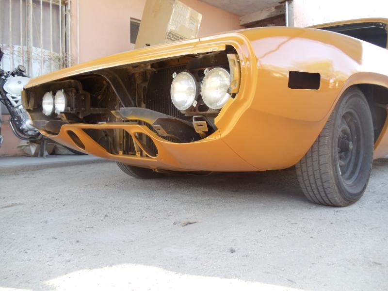

Getting ready to replace stock factory torsion bars with 1.03 diameter bars (PST) on a '72 Satellite Sebring Plus (318 auto). Will it make a big difference in ride/handling if I later add a front stabilizer bar or should I be satisfied with the simple torsion bar upgrade? Thank you.
