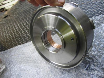

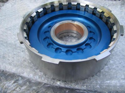

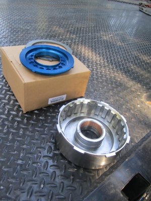

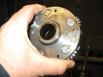

Some great info tight there:headbang:Some other upgrades to consider for higher HP levels are a manual valve body that has the shift kit included,a billit drum to protect the toesies and a 5 pinion steel planetary instead of the stock 4 pinion aluminum.This season I will be throwing over 900 HP and over 800 ft lbs of torque at my pushbutton trans.I don't plan on EVER switching from my buttons:sideways tongue:

A billet drum is a little more than I would need. haha I think my best bet is the red eagle clutches and a quality front band along with the 4.2 lever. Pat Blais is actually the one who had the rear clutch upgrade kit for sale, if you say he's on the level, then one of those will get the nod, too. The pump will be changed to the newer style for converter selection and I'm thinking a servo kit and governor swap should round things out.

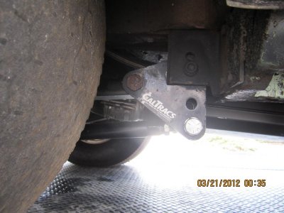

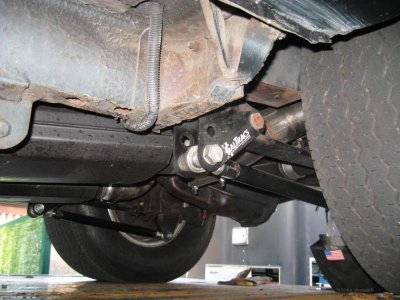

How do you like your Caltracs Hemi Itis?
When I went to Cal trac's,it was the ONLY adjustable choice.The only thing better would be a 4 link:tongue8:

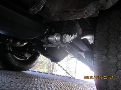

Yes,it was just as "Easy" as replacing superstock springs.I went with the split mono leaf spring and thier cal-bar.Mine are so old,the Rancho shocks only have a 5 way adjustment,newer ones have 9:black_eye:
I have been hunting for good pics and instructions. Does it mount right to the original front hanger? Seems to help your car pretty well. Still have the adjustable pinion snubber going with the setup?
No snubber!!:eusa_snooty:
Mounts on the exsisting front hanger.My springs are moved inboard,I did have to trim the front hanger for proper travel:toothy4:

Thanks for the input. Looks like imay have to sell my SS springs.
