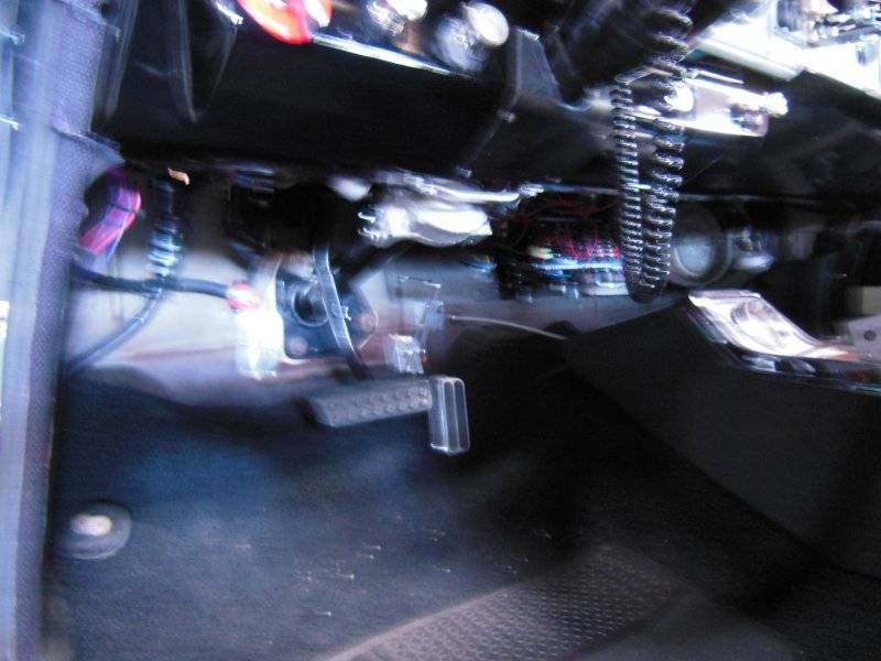

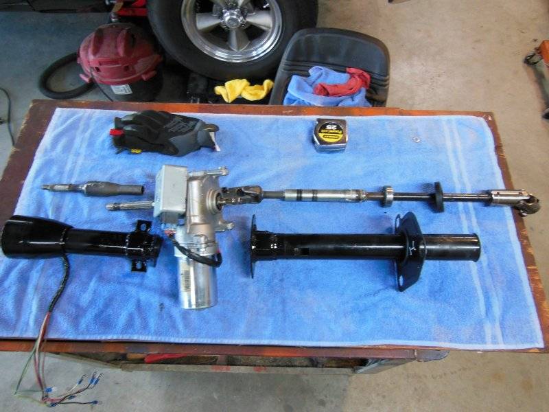

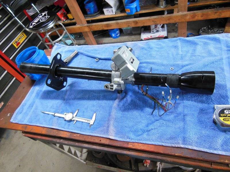

Maybe consider an electric power assist steering column instead of the usual hydraulic power steering. The electric power assist steering is available on some newer vehicles. A buddy is adapting this on his 64 max wedge Savoy. There is room under the dash to install the pieces.
i love mine, works great, no hydraulic oil and hidden under the dash. gps operated out of a 2007 saturn Vue.

1 finger steering ! lol, try it u will like it. best mod i did to the entire car,,i wish i would have known about this long ago...otherwise known as,,Hot rod power steering, summit even sells kits now. i built this 1 for a fraction of what they want.
